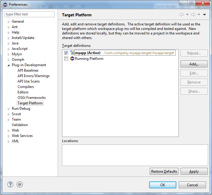

Can you please check which target platform is active?
Preferences > Plug-in development > Target Platform
index.php/fa/24485/0/
Eclipse will only take the dependencies provided in your Eclipse folder if you are using the "Running Platform" target platform.
BUT: the Eclipse RAP Framework is not available in the "Running Platform" target provided by your Eclipse IDE. This is why we have started to use an external target platform definition. You have probably a file <xxx>.target in your workspace. You should use this one.
Using target is mandatory:
* For Scout Applications using RAP
* If you want another version of Equinox/Eclipse RCP for your Application (most of the SWT I know still use Eclipse 3.8.2 as runtime platform)
* If you need libraries that are not provide by your "Running Platform"
I consider it as a good practice for all other cases.
I do not know exactly what you error is, my guess is that it is related to your target platform. Please provide more information about it (what does it contains?) and about the versions you want to use (Eclipse IDE Version, Scout Version, Eclipse RCP version for the Scout Application...)

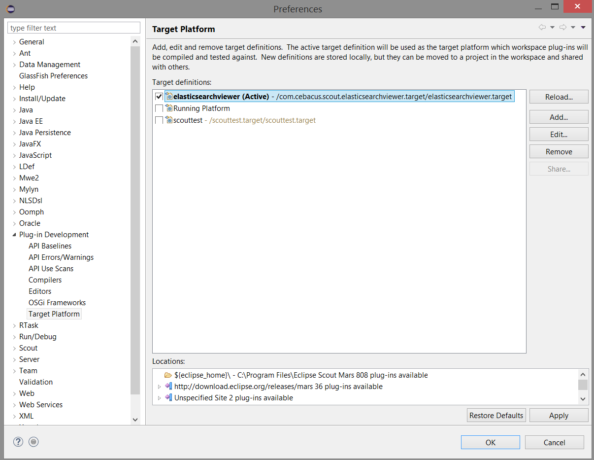

thank you for the hint. Actually I forgot where to change the target settings. I'm sure you are right that the target definition is somehow corrupted, but I'm not able to figure what the problem is.
As you can see the elasticsearchviewer target is selected.

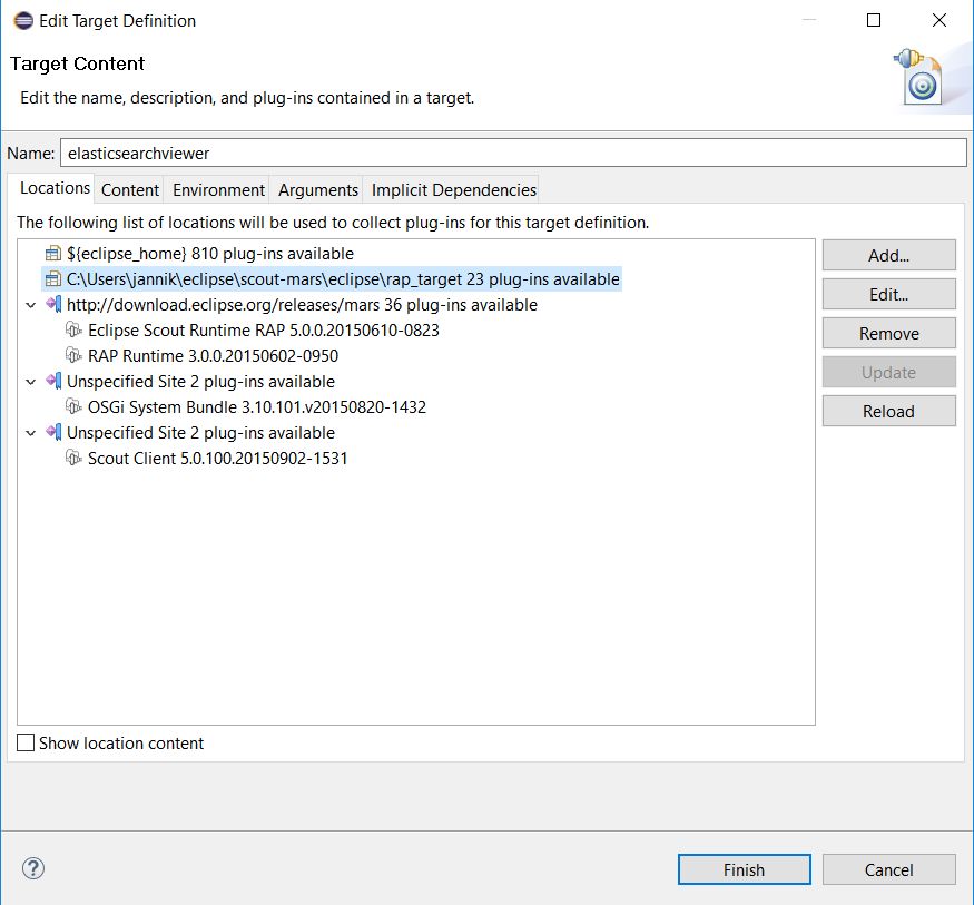

The content of the target file:

Update: Just deleted the duplicate tags. Still the same errors...
I'm using the lates Eclipse for Scout Developers (Mars) on Windows 8.1

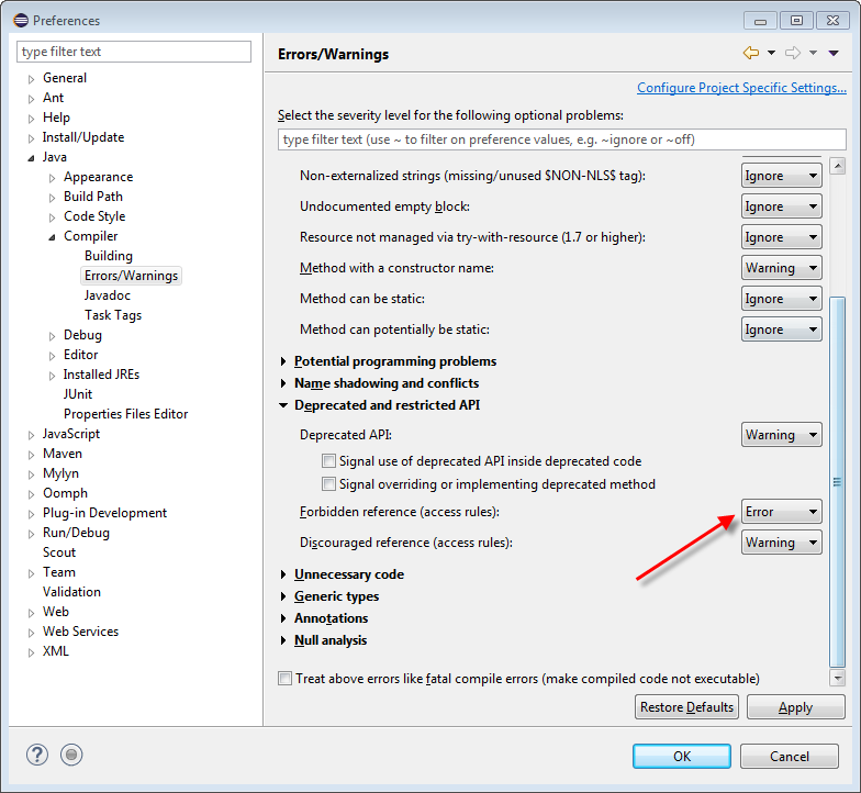

have you already tried to change the java compiler settings according to this stackoverflow [1] post? i haven't tried this but you might have the same problem...
the setting is located on the preferences dialog
index.php/fa/24880/0/

Thank you for your reply.
I tried this one out. But since this a compiler setting and my problems are eclipse workspace errors, in has no effect in my case.
Furthermore I would rather tackle the problem at it's roots than to avoid the symptoms by changing the rules.

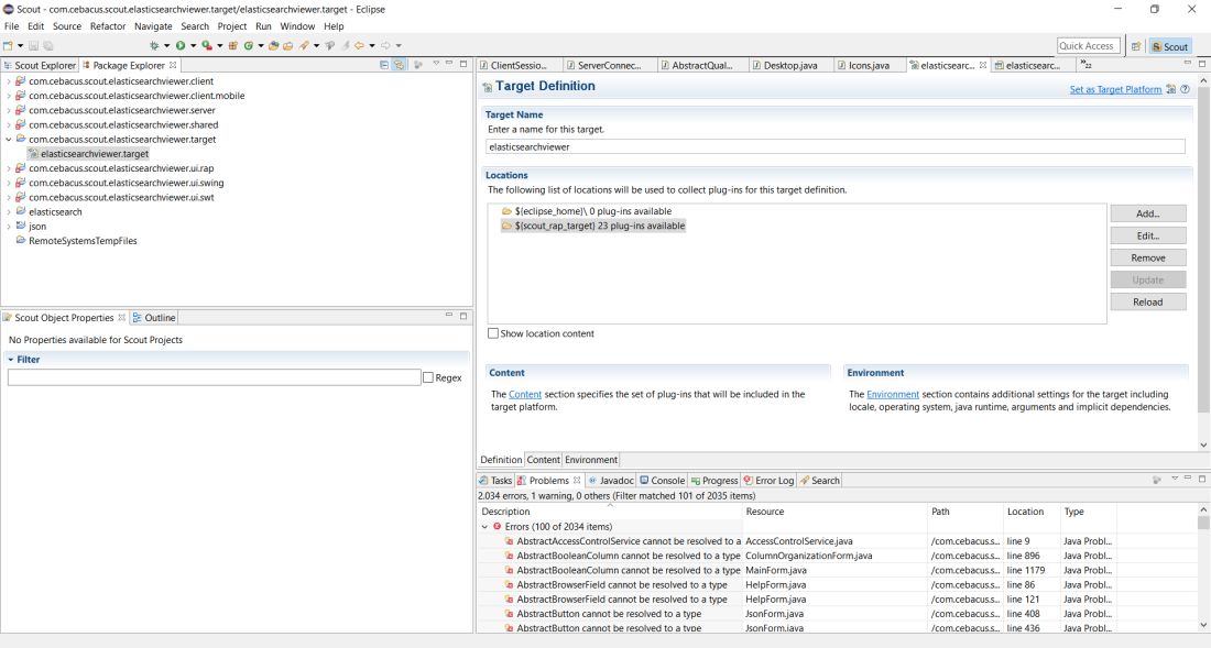

Unfortunately this hasn't helped me so far. No matter what I did, there where always serveral restriction access errors.
I tried the common solutions I found for those kinds of errors like readding the JRE library, changing the order of the plugin dependencies, set forbidden reference signal from error to warning, setup new projects in new workspaces, tried various target definitions etc., but the right combination was obviously not among them.
I promised myself the most of getting the workspace that Matthias sent me running, because I know it already worked on his system.
When I start a eclipse scout instance in this workspace the target definition doesn't work, because the "scout_rap_target" configured there points to a directory on Matthias' system. To get rid of it I changed it to point to the folder "rap_target" in my eclipse installation directory to look like this:
index.php/fa/24953/0/
Does anyone know, what to do next? I don't want to mess this workspace up too by doing something I'm not completely familiar with. So I hope for some advice. I have other workspaces and projects I can tinker with Wink

You can change the "scout_rap_target" by hand.
Preferences > Run/Debug > String Substitution.
Select the variable in the table and click on Edit.
The value you need is probablly
{your eclipse installation folder}/rap_target
More details: https://wiki.eclipse.org/Scout/NewAndNoteworthy/3.9#Variable_Local_RAP_Target_Location
I will try to check with Matthias, when I see him. You should definitivelly use a target file that contains only P2 Repositories. This way it will work everywhere.
Re: Access restriction: The field 'XXX' is not API (restriction on required lib XXX) [message #1723112 is a reply to message #1723093] Thu, 11 February 2016 12:51 Go to previous messageGo to next message
Yeah, I already did that. This is what you see on the screenshot.

In the screenshot I see 2 Folders and 0 P2 Update Sites in your target Platform:
* ${eclipse_home}: somehow broken, you have 0 plugins loaded from there.
* ${scout_rap_target}: seems to work. 23 plugins available seems good to me.
Your other target platform containing only update sites seems OK. Doesn't it work for your elasticsearchviewer workspace?
Re: Access restriction: The field 'XXX' is not API (restriction on required lib XXX) [message #1723118 is a reply to message #1723117] Thu, 11 February 2016 14:25 Go to previous messageGo to next message
No, unfortunately nothing works without errors...
Re: Access restriction: The field 'XXX' is not API (restriction on required lib XXX) [message #1723143 is a reply to message #1723118] Fri, 12 February 2016 01:46 Go to previous messageGo to next message
I can not imagine that you have exactly the same error with 2 different target platform.
Or something else is broken in your workspace.
An other thing you can try to force PDE to reload from the target platform:
* close eclipse.
* open the folder {your workspace}\.metadata\.plugins\org.eclipse.pde.core (in windows explorer)
* delete the folders: .bundle_pool, .caches and other cache folders (in .p2/org.eclipse.equinox.p2.core and .p2/org.eclipse.equinox.p2.repository)
* reopen Eclipse
* open your target file with the target editor
* wait until the editor has loaded everything (you should see the number of plugins found in each update site)
* select "Set as target platform"
* open "Project > Clean..." menu and then select "clean all projects" to force a complete rebuild.
Re: Access restriction: The field 'XXX' is not API (restriction on required lib XXX) [message #1723162 is a reply to message #1723143] Fri, 12 February 2016 04:28 Go to previous messageGo to next message
I didn't mean they produce the exact same errors, but the result is pretty much the same: hundreds of erros because of access restrictions - or (as you see on the screenshot in my last post) the plugins can't even be resolved, because eclipse_home is wrong.
When setting the target with the remote locations, eclipse loads target information and rebuilds the workspace. Only client, client.mobile and the server have access errors like you see in the appended screenshot
[Updated on: Fri, 12 February 2016 04:42] by Moderator
Re: Access restriction: The field 'XXX' is not API (restriction on required lib XXX) [message #1723431 is a reply to message #1723162] Mon, 15 February 2016 10:51 Go to previous message
With Matthias' help I found out, why I couldn't get his workspace running on my system. As you see on one of the previous screenshots, the problem was that the 'eclipse_home' target couldn't resolve any plugins, although the directory it pointed to was fine.
I found out that in the target file it was declared as a location of the type 'Directory' instead of 'Profile'.
So I deleted and readded it with the target editor via
'Add...'->select 'Installation'->'Next >'->'Variables...'->select 'eclipse_home'->'OK'->'Finish'.
This should produce the location entry
<location path="${eclipse_home}" type="Profile"/>
in the traget file.
After these fixes the workspace was running without errors. My old workspace still doesn't work with the same target file and the same eclipse installation. I don't know what's going wrong.
It would be great If I could get my old workspace running again, as there is a git repository and some other documents which I would have to carefully move over to the new workspace potentially causing new errors.
Matthias recommended to spend not too much time for the target issues and trying to migrate to Scout Neon instead. I'm not sure whether this would be sufficient for me, as I rely on a (standalone ) desktop build of my application. My latest information is that there will no longer be a desktop renderer in Scout Neon.
