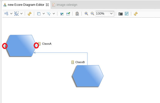

We are using Sirius 3.x and what is described in this example works correctly : the transparent pixels are not considered as the path of the shape. But this is not what I need. To continue with the given example, what I need is to force the link to be connected with the left and right apex (in the red circles in my picture). Is it possible by modifying the SVG shape properties ? Or to define the anchors in the odesign model ?
Jonathan

Ok I understand better, the layout of the edge depends of the router
used, the bendpoints and the anchors defined in the notation model. The
router can be defined in the odesign model and can be customized in the
diagram editor through the tabbar or properties view. For example the
tree router could be useful for your need. In addition in odesign model,
you can use "Ends Centering" property available on Edge Style to have
always the edge centered on source, target or both.
Best Regards.
