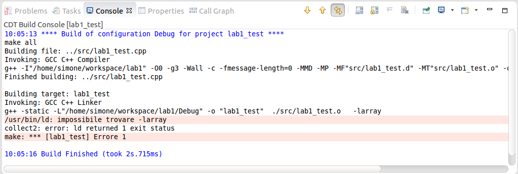

Re: How to link a static library in C++? [message #1716880 is a reply to message #1716854] Tue, 08 December 2015 13:21 Go to previous messageGo to next message

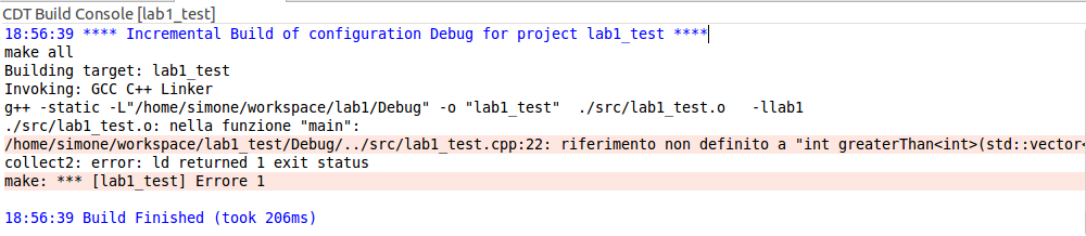

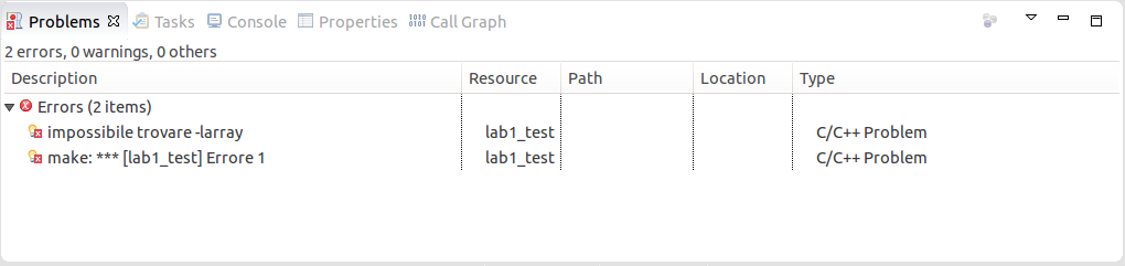

Ok I described you all that I made.
First of all in eclipse I created a new C++ project. I selected static library, empty project, called the project name lab1 (as it's an exercise for university) and I selected the toolchains "Linux GCC". Then I created two files: array.h, where I wrote the prototype of functions, and array.cpp where I implemented my functions and I included array.h ( #include "array.h"). I built the library and all it's ok as the compiler doesn't show me error.
So I created another project called "test_lab1.cpp" where I'd like to test the functions that I implemented in my library. I included the library (#include "array.h") and I made all that i could make in project properties to link the library in test_lab1.cpp but now the compiler shows me error that it can't find the library.
So I ask if you can tell me what I have to do to link my library.
I'm attaching you a screen of the error. I hope you can understand the language because It's written in Italian.
Thanks again! Smile

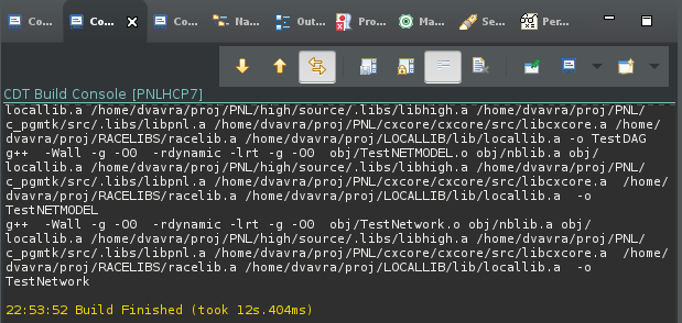

I still need to see what the link command actually is being used. It should be near the bottom of the build log which should be appearing in a console view during the build.
Typical build log in a console view:
index.php/fa/24223/0/
Note how I specified obj/nblib.a and obj/locallib.a. I had to do this because they don't follow the libXXX.a naming convention. I create my own makefiles. Specifying lib files in CDT is sometimes tricky as the position order can be significant. I don't think it is in your case though.
The others could have been specified using -L and -l, for example: /home/dvavra/proj/PNL/high/source/.libs/libhigh.a could have been specified by
-L/home/dvavra/proj/PNL/high/source/.libs
-lhigh
Please post the full path to your library as well as its complete name.

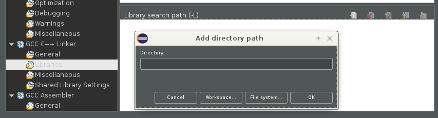

My guess is (if the name is libarray.a) you haven't provided the proper path with the -L option. The build command will should have it. GCC will not complain about incorrect path names.
Since it is in another project you can use the the Worlspace... button to specify a file in the current workspace (assuming both projects are in the same workspace and the project files are in the workspace).
When you build. you should see -L<path-to-libarray.a> -larray on the linker line with <path-to-libarray.a> as the actual path.
index.php/fa/24222/0/

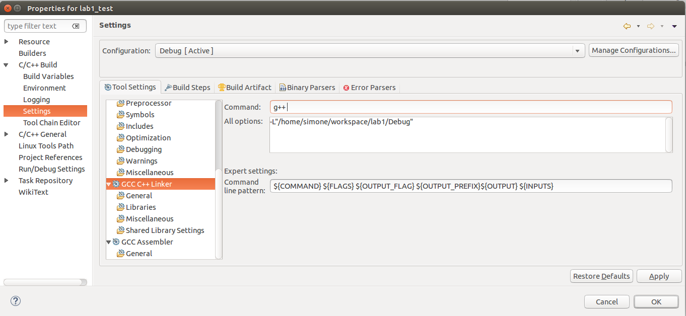

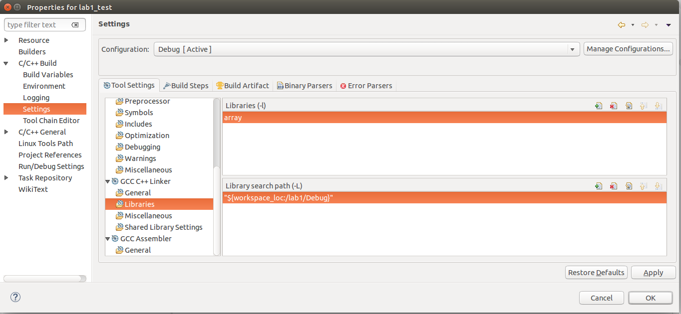

Re: How to link a static library in C++? [message #1716951 is a reply to message #1716907] Wed, 09 December 2015 04:21 Go to previous messageGo to next message
Hi David,
So to specify the position of my library I used the workspace... button.
I'm attaching screens about the properties of linker, the properties of library and the console when I build the project.
Thanks Smile
Re: How to link a static library in C++? [message #1717007 is a reply to message #1716951] Wed, 09 December 2015 10:08 Go to previous messageGo to next message
Simone,
The link command looks correct..
Open a command window and list the contents of /home/simone/workspace/lab1/Debug
The linker is trying to find /home/simone/workspace/lab1/Debug/libarray.a
Does this file actually exist? I don't think it does.
I think the confusion is that the default name of the library is libPROJECT_NAME.a and you are assuming it will be libarray.a.
I made a static test library project called HelloC++Lib with the single function Afunc.
The library produced was named lib HelloC++Lib.a
These are the contents of the Debug directory in /HelloC++Lib:
[dvavra@fred ~]$ ls ~/workspaces/workspace/HelloC++Lib/Debug/
Afunc.d  Afunc.o  libHelloC++Lib.a  makefile  objects.mk  sources.mk  subdir.mk
If the project is named lab1, the library name will default to liblab1.a
Try changing the linker command in your test project to -llab1

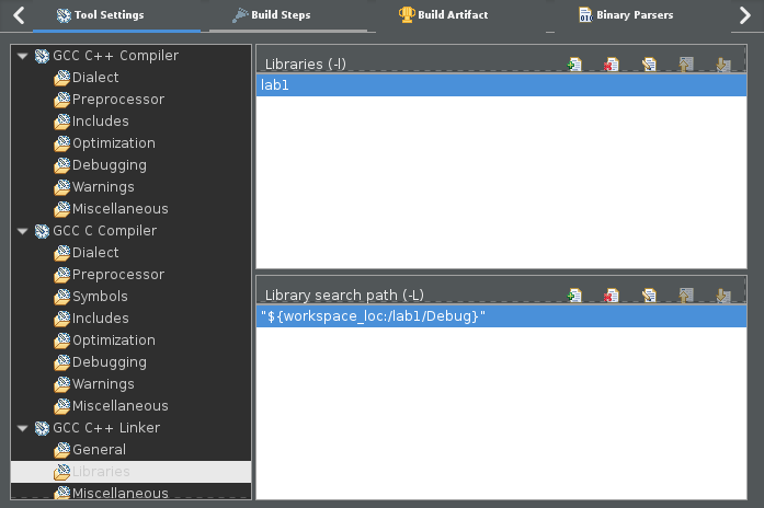

Re: How to link a static library in C++? [message #1717041 is a reply to message #1717039] Wed, 09 December 2015 12:42 Go to previous messageGo to next message
Go to Project ==> C/C++ Build ==> Settings an on the Tool Settings tab select GCC C++ Linker ==> Libraries and in the Libraries (-l) pane change array to lab1.
index.php/fa/24253/0/

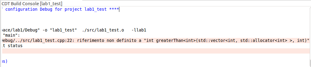

Re: How to link a static library in C++? [message #1717054 is a reply to message #1717041] Wed, 09 December 2015 13:02 Go to previous messageGo to next message
I've made it,
but now the compiler shows me another error.
Re: How to link a static library in C++? [message #1717065 is a reply to message #1717054] Wed, 09 December 2015 13:49 Go to previous messageGo to next message
Looks like it's a template function. You have to instantiate these somewhere.
Here's an example where I've instantiated Which<T> for STRING, int, UINT, float and double:
template<class T>
int Which(T val, const std::vector<T> & list);
template<class T>
int Which(const T nam, const std::vector<T> & list) {
	for (UINT i=0; i<list.size(); i++) {
		if (nam == list[i]) return i;
	return -1;
template int Which(STRING, const std::vector<STRING> &);
template int Which(int,    const std::vector<int>    &);
template int Which(UINT,   const std::vector<UINT>   &);
template int Which(float,  const std::vector<float>  &);
template int Which(double, const std::vector<double> &);

Re: How to link a static library in C++? [message #1717093 is a reply to message #1717075] Wed, 09 December 2015 16:24 Go to previous messageGo to next message
The lines saying
template <typename T>
int greaterThan(vector<T> v, T k){
just tell the compiler how the function should be built. It is a kind of declaration similar to the prototype you placed in your header file. Think of it as a kind of macro. It doesn't generate any code by itself. This definition has to be available for the compiler to actually build the function from the template using the desired type for T.
If the function prototype is declared in a header file, but the function body template is in a separate file, then the compiler wouldn't know how to implement it when you actually try to use it and will assume it has been defined and expamded externally.
So, when they are separate, you need to actually expand it for every type you intend to use. You do this with a line for each type. For example, for int:
template int greaterThan(std::vector<int> , int);
The line has to appear in the same file as the body template and the object for that file must be linked with the rest of your code.
