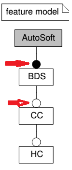

1: Can we have a custom edge style such as the one shown in the figure below, like the empty circle and the filled circle at the end of an edge? These are not defined in the predefined Sirius edge decorators.

1. Currently there is no easy way to customize edge anchor decorator. As
said by Claudia there is custom style [1] which allows to provide its
own GMF EditPart to customize for example the draw2d rendering, but this
custom style is only usable for Node but not for Edge and Container. If
you want you can raise a bugzilla enhancement about this need. Perhaps a
possible work-around could be to provide your own
"org.eclipse.gmf.runtime.diagram.ui.editpartProviders" extension with a
priority higher than the one defined in
org.eclipse.sirius.diagram.ui/plugin.xml to provide your own EditPart
extending DEdgeEditPart but be aware that it could impact all Sirius
based editors.
