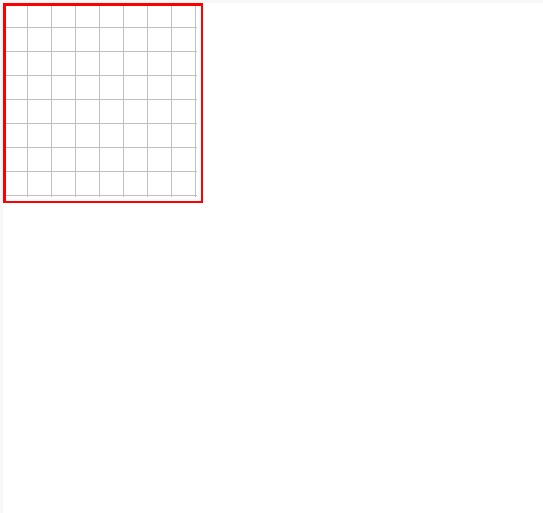

I implement a graphical editing tool with GEF.
It should be possible to adjust the diagram size and it should be prevented to drag new elements outside this size.
What I do is to override the createDefaultRoot method in ScrollingGraphicalViewer and write my own ScalableLayeredPane for which I override the createScaledLayers method, see below. Their I set the bounds for now on fixed size (200,200).
			protected ScalableLayeredPane createScaledLayers() {
				ScalableLayeredPane layer = new ScalableLayeredPane() {
					public Rectangle getBounds() {
						return new Rectangle(0, 0, 200, 200);
					public Border getBorder() {
						return new SchemeBorder(SCHEMES.BUTTON);
					public void paint(Graphics graphics) {
						super.paint(graphics);
						graphics.setLineWidth(5);
						graphics.setForegroundColor(red);
						graphics.drawRectangle(new Rectangle(getBounds()));
						graphics.scale(getScale());
	protected void paintClientArea(Graphics graphics) {
		if (getChildren().isEmpty())
			return;
		if (scale == 1.0) {
			super.paintClientArea(graphics);
		} else {
			ScaledGraphics g = new ScaledGraphics(graphics);
			boolean optimizeClip = getBorder() == null
					|| getBorder().isOpaque();
			if (!optimizeClip)
				g.clipRect(getBounds().getCropped(getInsets()));
			g.scale(scale);
			g.pushState();
			paintChildren(g);
			g.dispose();
			graphics.restoreState();
The current state after I made these changes:
index.php/fa/23923/0/

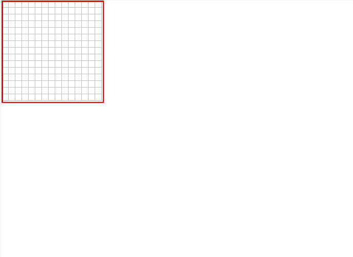

After zoom:
index.php/fa/23924/0/

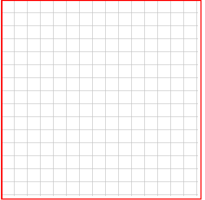

1. What I want to achieve is that the diagram size should be adjustable and
2. in case of zooming it should be not zoomed inside the diagram, the zoom should affect the whole diagram, like this.
index.php/fa/23925/0/

The bounds you specify on the ScalableLayeredPane are absolute (as the pane itself is not zoomed). You would have to dynamically adjust these bounds based on the scaling that is applied by the ZoomManager.
Re: Variable Diagram Size [message #1714616 is a reply to message #1714577] Fri, 13 November 2015 19:15 Go to previous messageGo to next message
But how I can achieve that the pane has a default size from (200, 200)?
Re: Variable Diagram Size [message #1714675 is a reply to message #1714616] Sun, 15 November 2015 09:50 Go to previous message
İt's possible to create or move elements outside the diagram size. Should I prevent this by commands or are their any other ways to do this?
