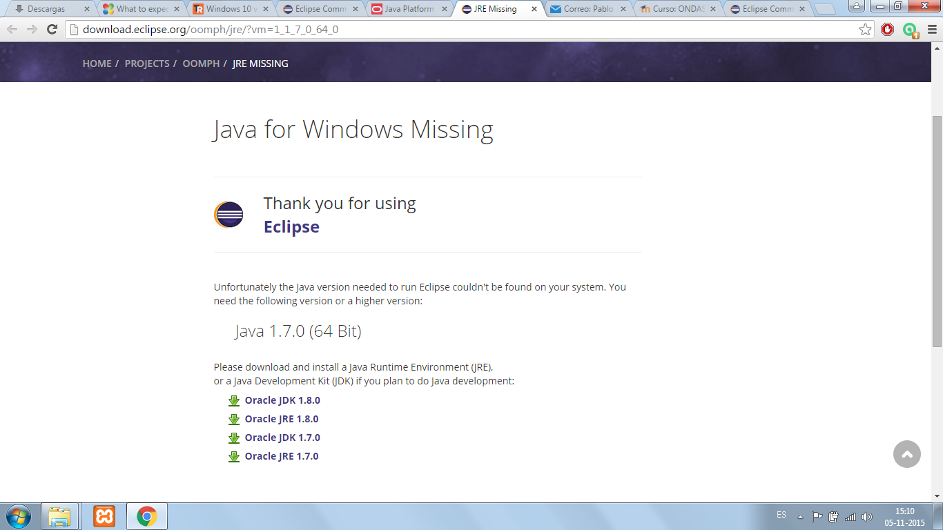

Hello, I downloaded the files eclipse -inst-win64 and jdk-7u79-windows-i586.
Installed java first and then tried to install eclipse, but it opens the browser giving me the messaje "java for windows missing", as you can see in the picture.
I tried installing different versions of java , uninstalling them, etc. but eclipse is not installing, it keeps showing that error. Sad
Help me please, thank you in advance.

Solved by installing the 32 bits version, my sistem is 64 bits though.
Re: Can't install eclipse [message #1713809 is a reply to message #1713683] Fri, 06 November 2015 11:53 Go to previous messageGo to next message
Just because your OS is 64-bit does not mean that the version of Java you installed is 64-bit. 32-bit applications (including Java and Eclipse) can run just fine on 64-bit systems.
The real requirement, as described in the announcement message that Russell referred to, is that the bit-ness of Eclipse and Java match, regardless of your system OS bit-ness.
