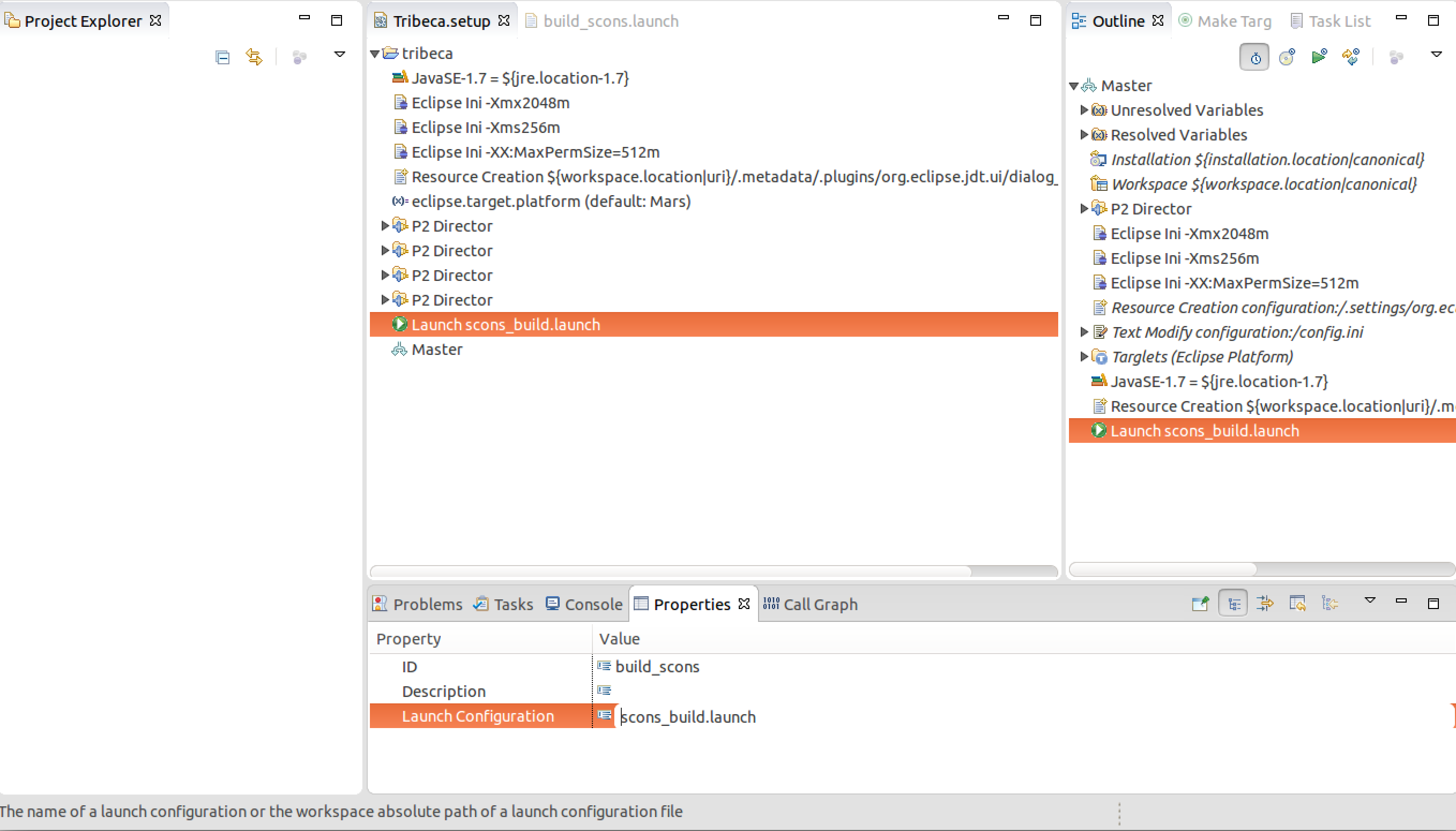

HI Ed,
In this example, they assign "Generate Language Infrastructure (it.xsemantics.example.fjcached)" or "GenerateFJ.mwe2" in the "launcher" field. None of them looks like a relative/absolute path to a .launch file. Can you give more details on that? Is having only the .launch file enough or I need to create some Targlets or Component Extension tasks?
I attached the screenshot with the setting for my launch task.
Artem

None of them are the absolute or relative path. They specify just the
name of the launcher. I.e., the last segment of the path without the
file extension as you see it in the menus and in the Name: field of the
configuration dialogs. If the launcher depends on projects that must
be built first or on plugins in the target platform, you likely need a
build task first. The Xsemantics setup is in Oomph's Github project
catalog, so you can try out how it works.

Ed is right: first ensure the project containing the .launch file has
been built. Afterwards you just specify the file name without the
..launch extension and it should work.
Axel

The blog actually says
"For the “Launch” task, you need to use the name of the .launch file,
without .launch."
And as Ed said, you first need to ensure the project containing the
..launch is in the workspace... (if I remember correctly, the build task
is not required for the launch configuration to be found: it is required
for the mwe2 launcher class to be found.)
cheers
Lorenzo
