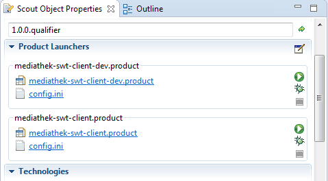

I am using Eclipse Mars and Scout Mars (have not yet upgraded to SR1). I have both a development and production product, both work when started from within eclipse.

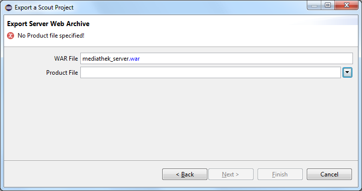

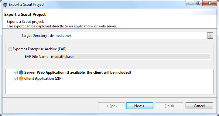

When I start the export process, I am guided through these steps:
index.php/fa/23704/0/
index.php/fa/23705/0/

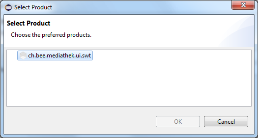

When I now click on the browse button, I get a popup showing my SWT project, but it does not list any of the two products that are present in that project:
index.php/fa/23706/0/
Is there an additional step that I need to take to make those products visible?

Replying to myself: I found out why I got stuck on step 3: Because I have a standalone application, there is no sever product and the step I got stuck on was apparently trying to get me to choose a server product (even though it showed the client project). Deselecting "Server Application" in the first steps got rid of that issue and I could then select my client product in the next step.
I now have an executable that starts both server and client and I'm perfectly happy. Sorry for the noise here, hopefully it will help somebody else avoid the same mistake.

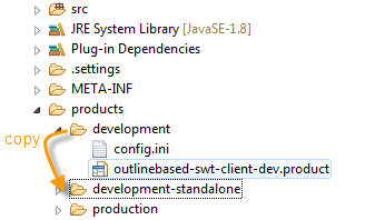

Re: How to export a standalone application [message #1713404 is a reply to message #1713366] Tue, 03 November 2015 14:36 Go to previous messageGo to next message
This is simple:
Copy the project folder you are interested in (dev is intended to be started from the IDE, prod is intented to be build and to be used in production).
index.php/fa/23821/0/
In this example I have created the "development-standalone" folder a copy from "development".
* I recommend to rename your product file (in order not to confuse them later) => In this example I renamed it to "outlinebased-swt-client-dev-standalone.product"
* In {your app}/products/development-standalone/config.ini put the expected setting. Something like "server.available=false"
* Open the outlinebased-swt-client-dev-standalone.product and do following changes:
** In the Overview Tab, change the name (this is optional but better).
** In the Configuration Tab, update the "Use an existing config.ini file" value to /{your app}/products/development-standalone/config.ini.
I hope this helps.

Just had another weird problem. It's is sometimes hard to persuade Eclipse to stay in sync. The config.ini were all correctly set in the products 'Configuration' tab and I was able to start them via the products 'Overview' tab. However, by starting with the Scout Object Explorer it always chose the wrong config.ini. After more than one time clicking "Synchronize this configuration with the product's defining plug-in" everything worked correctly.
