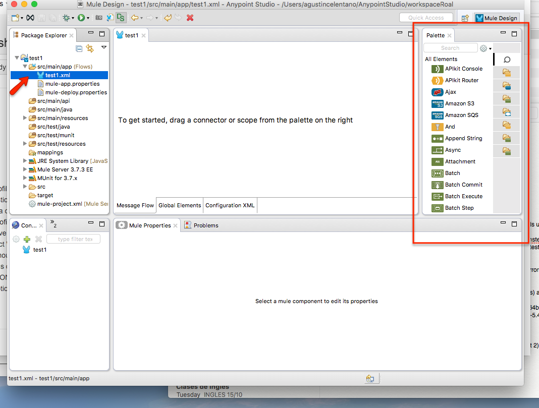

Steps to reproduce:
1) Create a new mule project. (Screenshot 1)
2) Open the mule configuration file from the package explorer. (Screenshot 2)
3) Run the test.
ISSUE: Nothing appears to happen. You have to kill the test.
