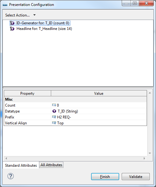

> what steps might I be missing?
Carefully check the following: (1) The ID-Generator is associated with a DatatypeDefinition; (2) There must be an Attribute using that DatatypeDefinition; (3) The Attribute belongs to a SpecObjectType; (4) Only SpecObjects using that SpecObjectType will receive IDs.

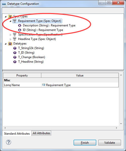

Yes, I have this setup - but I'm not seeing my numbering used:
index.php/fa/23377/0/
index.php/fa/23378/0/
Re: ID-Generator auto-numbering. [message #1709483 is a reply to message #1709419] Mon, 28 September 2015 16:03 Go to previous messageGo to next message
What Datatype are you using for RequirementType.ID?
Re: ID-Generator auto-numbering. [message #1709548 is a reply to message #1709483] Tue, 29 September 2015 04:41 Go to previous messageGo to next message
I thought I had set it correctly:
index.php/fa/23383/0/

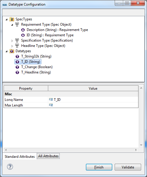

Re: ID-Generator auto-numbering. [message #1709557 is a reply to message #1709548] Tue, 29 September 2015 05:56 Go to previous messageGo to next message
Hi Max,
From the screenshot I cannot see what I am looking for: You need to select "ID" (the Attribute of "Requirement Type". Then you would see in the lower pane, which **Datatype** is assinged. If it is T_String32k (as I suspect), then you'd have to change it to T_ID.
But maybe I am on the wrong track.
Best,
- Michael
Re: ID-Generator auto-numbering. [message #1709560 is a reply to message #1709557] Tue, 29 September 2015 06:05 Go to previous message
Bingo! Thank you very much. I had the SpecType (SpecObject) and the datatype T_ID but hadn't applied the T_ID as the SpecObject attribute type for string, as you suggested!
Happily numbering away now!
