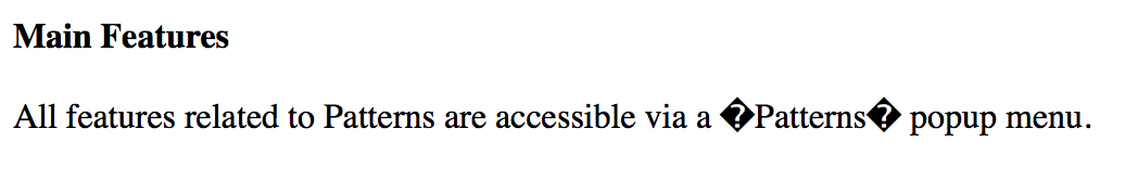

Great! I have seen the documentations, but some punctuations can not be displayed in the webpages. (see my attachment of a screenshot)

- Punctuation in doc: Nice catch! This punctuation problem doe not show up on my computer. I've just fixed it (Bug #476351), it should be OK now if you pull.
