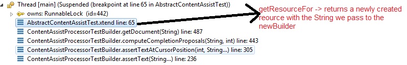

Re: Test Content-Assist withing maven build [message #1705777 is a reply to message #1705739] Wed, 19 August 2015 03:03 Go to previous messageGo to next message
I tried to do what you suggested, with relevant modifications for my project:
    1. The project "contentAssistTest" was created in the workspace and was added
    the Xtext-Nature.
    2. Then I changed the DSL-file to be created to stand in my DSL-grammar rules -
    For the sake of the discussion, i created a Parent component which i will later would want to reference when testing a Son component.
    And then i ordered IResourcesSetupUtil.waitForAutoBuild(); (What is 'reallyWaitForAutoBuild' Shocked )
Till Here everything is O.K:
It really creates me a project with the file i want to reference, and Xtext generator generates files as needed.
Now, in my @test testCompletion() method, i create a Son component in a progression way using the newBuilder, append and assertText.
When i try assert for the Parent which is in the file that was created, the computeCompletionProposals returns me an empty array of proposals.
(pic. attached)
Why does it happen?

and creating a project with Xtext nature and builder at the background, and in this project I create files as resources which I want to cross-reference in my testing.
But I have a problem with the scoping. In the scoping I check that the resource is a physical file, which was a solution to avoid round-inheritance.
On the other hand, the computeProposals() method creates a resource from the newBuilder.append..... using the AbstractContentAssistTest.getResourceFor() method, and this resource is not a physical file, and thus the scoping check fails.
As for now, I'm avoiding this by creating a Degenerate physical-file for this resource on the Xtext-background project, but this is a bad solution as some of my resources could be very complected.
How can I test cross referencing If the scoping (which first get all relevant resources including the one I'm building with newBuilder.append) and its check is a must (to verify no round inheritance)and it test that the resource is a physical file?
