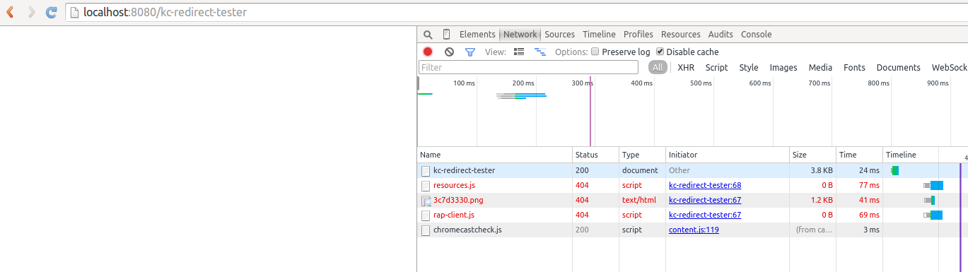

I have my application entry point defined following:
<extension
         point="org.eclipse.rap.ui.entrypoint">
      <entrypoint
            brandingId="com.ibm.kc.redirect.validator.rap.branding"
            class="com.ibm.kc.redirect.validator.rap.app.ApplicationWorkbench"
            id="entrypoint"
            path="/">
      </entrypoint>
   </extension>
It works on IBM WAS, but when I deploy WAR onto tomcat7 (webapps folder) I see some 404 for RWT js etc. See attached picture
When I define different path to RAP servlet it works fine.
Re: RAP application entry point defined to &quot;/&quot; not working on Tomcat7 [message #1703587 is a reply to message #1702712] Mon, 03 August 2015 08:05 Go to previous message
we have this bugzilla:
429443: Requests to Root Path Entry Point are not redirected correctly
in WAR deployment
https://bugs.eclipse.org/bugs/show_bug.cgi?id=429443
Please add "/" to the end in your URL:
http://localhost:8080/kc-redirect-tester/
Does it help?
Ivan
