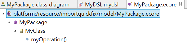

My ECore resource looks like this:
index.php/fa/22450/0/

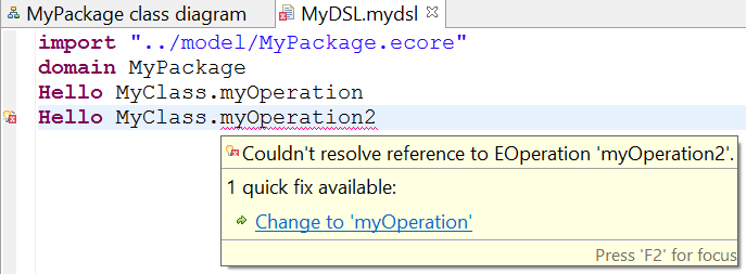

And my example looks like this:
index.php/fa/22451/0/
The EOperation 'myOperation2' does not exist and I want to have a quickfix to add it to the imported model.
How can I do that? For my own validator errors and warnings I can specify an ID to use for a Quickfix. Since this is a build in error, I do not know the ID. Is there an ID or another way to do this?
