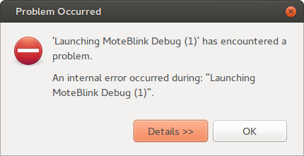

But other appears instead when I run Profile tool (small green triangle on toolbar), please see the image in attachment
