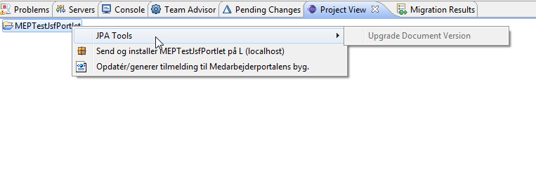

after upgrading to eclipse 4.2 my viewpart starts to show elements from the navigator menu. Any suggestions what to do?
Please see attached screenshot:
index.php/fa/21957/0/

Someone's contributing a context menu for whatever objects your view is displaying. You can either uninstall/disable that plug-in, or file a bug report, but it's basically working as designed.

Thanks for the reply. Actually i haven't changed anything for years in the code, and now on RAD9.0.1 it starts to behave like that. So i thought it was a bug.

Is it possible to find out which plugin is contributing the context menu, and maybe to remove it during runtime?
Re: Eclipse viewpart showing too much elements [message #1696719 is a reply to message #1696713] Thu, 28 May 2015 04:14 Go to previous messageGo to next message
I was thinking about filing a bug report, but i am not sure where to file it. If Eclipse is working as designed, then i need to know if it is a third part plugin that is causing the problem, and then file a bug report there.
Re: Eclipse viewpart showing too much elements [message #1696761 is a reply to message #1696719] Thu, 28 May 2015 08:55 Go to previous message
You can use the Plugin Spy to track down what plugin is contributing the menu item. See this Q&A on Stack Overflow for more details: http://stackoverflow.com/questions/6209033/how-to-determine-which-eclipse-plugins-are-contributing-to-menus-and-toolbars-an
