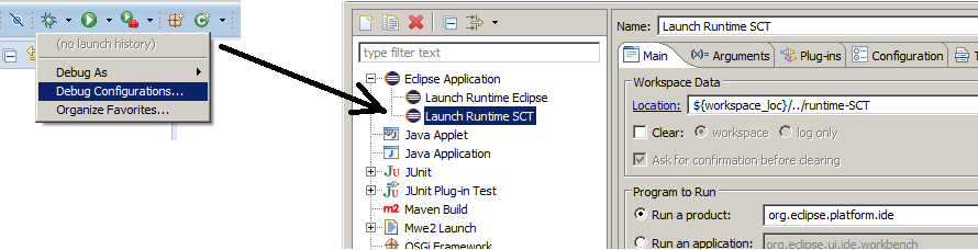

I'm working on an Oomph-Setup-file and I wonder if it is possible to set Launchers to the Launcher History. So a user only have to click on the run/debug symbol instead of "run Configurations...", search for the launcher and run it.
On this screenshot you can see, history is empty (left side).
There is a launch config I would like to set as default (SCT, right side).
Possible?

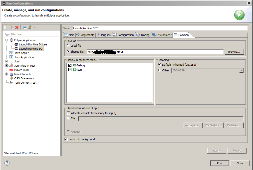

I don't think it's possible to influence the history (other than simply executing a launch), but have you tried to check
"Display in favorites menu" on the Common Tab of the launch configuration?

But I don't have any "Display in favorites menu" check on the Common Tab of the launch configuration.

I see a "Display in favorites menu" viewer in your image and both your
Run and Debug appear to have the check mark enabled...

thank you for your reply. Now I see it Wink
Is there any way to add launch-favorites through Oomph-Setup?

No. It seems to me more of an Eclipse bug that things marked as
favorites do no initially appear in the menu...
