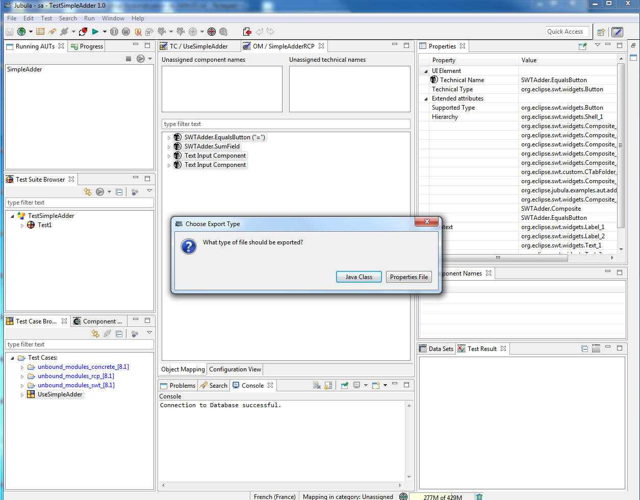

Finally, I found the way to create the objectMapping_SimpleAdderRCP.properties file.
So, I launched Jubula (version 8.1.3.033). I used it as usual : Connexion to the agent, Open database, Open Test Case, Launch the application. After this, I started Object Mapping Mode and Jubula gives me the list of the GUI components and their association. There, I select the whole list and right-clic on the selectd items -> USE in API -> Export Object Mapping to File. A window opens and I selected Properties File (there is another choice that is "Java Class"). index.php/fa/21859/0/
And That's all.
