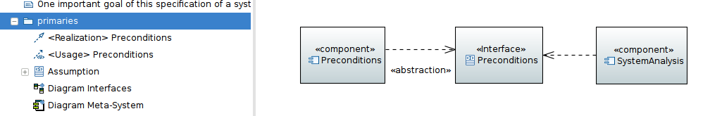

I am new to Papyrus and I cannot find a tutorial or other description on how to show the symbols for provided/required interfaces (lollipop/fork).
I found this contribution on the forum:
https://www.eclipse.org/forums/index.php/t/449263/
It highlights the problem but does not provide me a working solution.
Some detail:
I dragged the Realization from the model to the diagram.
I expected a lollipop attached to the realizing component.
I got a box and a dependency, showing that the component is abstacted by the interface.
I dragged the Usage from the model to the diagram.
I expected a fork attached to the using component.
I got a dependency of the using component on the interface.
What did I wrong?
