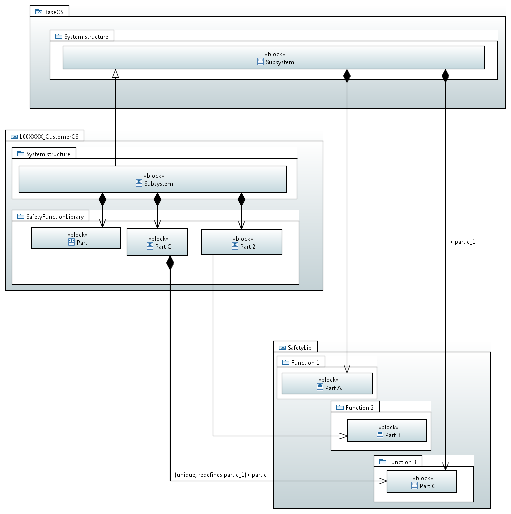

Hi Charles!
Interesting discussion, since I have, while trying to figure out what is wrong with my imports tried to visualize how my models needs to be interconnected. See the attached image. Actually this image is not exactly how things are at the moment, but rather a concept of a future structure, but still shows the principals of design.
index.php/fa/21614/0/
BaseCS is a skeleton control system that my company adapts or refines for a specific customer by adding customer specific function or when necessary, modifying those already in the skeleton system.
Would you say the way it is modeled could be improved in any way?
Tomas Sandkvist

Hi Tomas,
Assuming that all elements are public within their namespaces (packages), this looks fine.
