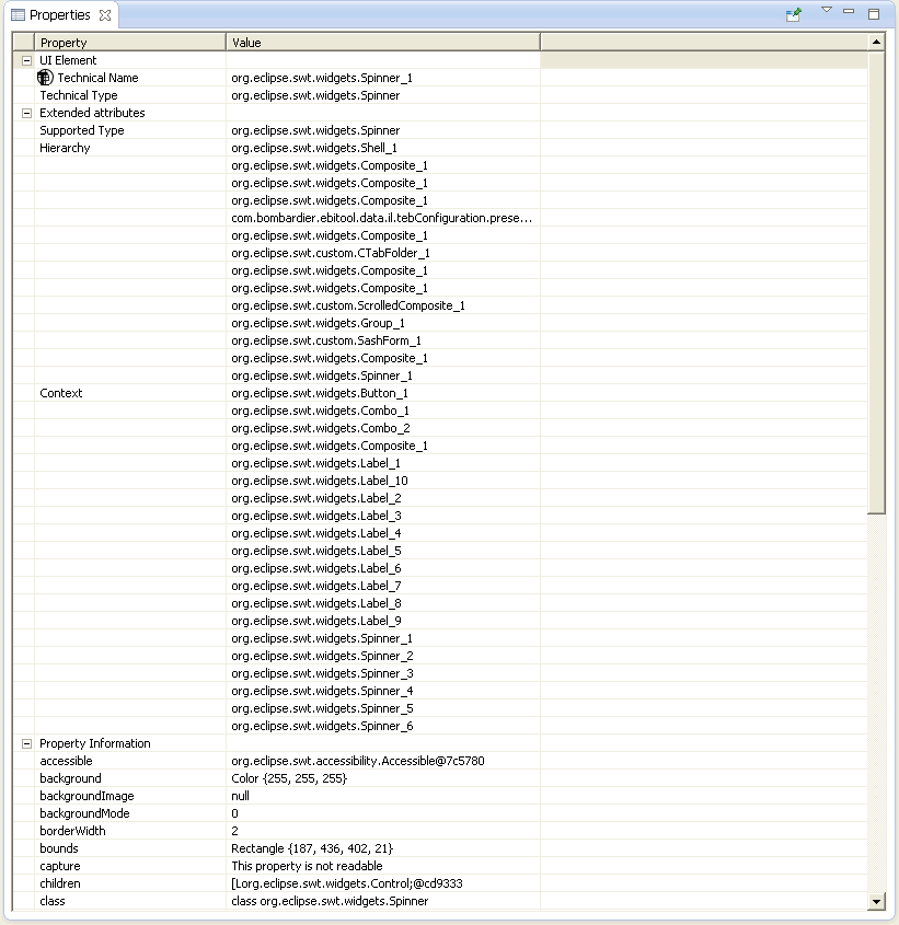

I have tried all possibilities but can't find out how to check a value of a "Spinner" UI element. It's no problem to select the UI element and the value in it, but I can't find any way of checking the value in the UI element.
See attached screenshots for more information.
Anyone who knows how to do this?
Thanks in advance!
Regards Richard
Spinner UI element
index.php/fa/21541/0/
Properties of the UI element
index.php/fa/21542/0/

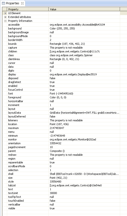

Re: How to check value of "Spinner" UI element? [message #1692468 is a reply to message #1692369] Thu, 16 April 2015 02:10 Go to previous messageGo to next message
The "Properties" are now included as screenshot. I can't figure out which information to use for "Check property".
I would really like the check "Component with Text" to support "Spinners". I found this bug: https://bugs.eclipse.org/bugs/show_bug.cgi?id=425310
is that correct or should I write a new one? Please prioritize if possible!
Regards Richard
index.php/fa/21557/0/
Re: How to check value of "Spinner" UI element? [message #1692486 is a reply to message #1692468] Thu, 16 April 2015 04:44 Go to previous messageGo to next message
Hi Richard,
I'd go for the one called "text". It has a value of '1', which is the value shown in your screenshot.
That enhancement is a different toolkit - so I'd suggest entering a new one.
Hope that helps,
Alex
Re: How to check value of "Spinner" UI element? [message #1692495 is a reply to message #1692486] Thu, 16 April 2015 05:12 Go to previous message
"ub_grc_checkProperty" works perfect with the PROPERTY_NAME = "text" as you suggested.
