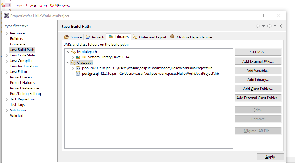

Re: Can't get classes in Referenced Libraries recognized. [message #1832323 is a reply to message #1692403] Wed, 16 September 2020 06:44 Go to previous message
No luck yet.
I created a sub-folder 'lib' underneath the project folder and copied the external JAR files in there ( related to JSON ). Still getting an error "The type org.json.JSONArray is not accessible" with the red cross mark in Eclipse IDE. This is after adding the JAR files via 'Build Path -> Configure Build Path -> Libraries -> classpath -> External JAR files...". Screenshot attached herewith.
I will attempt to created a Maven project in the meanwhile.
Any support to resolve this issue will be much appreciated.
Thanks!
