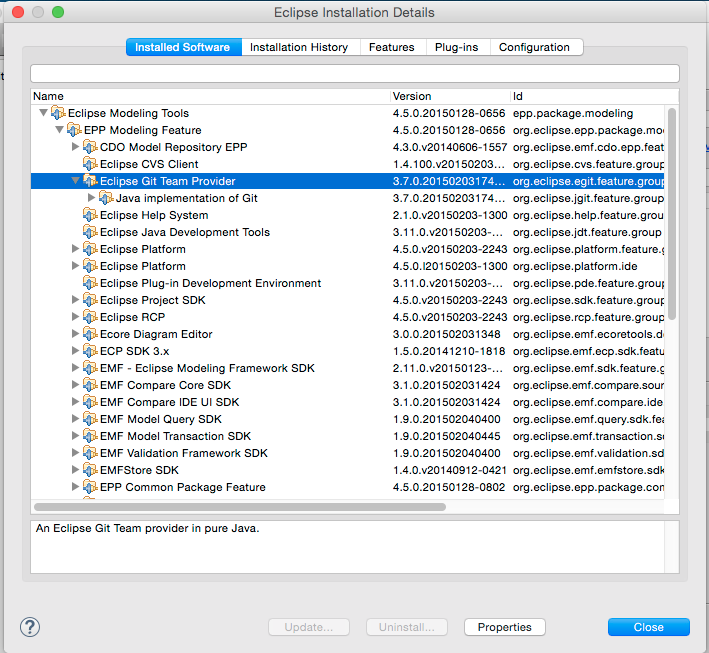

I've got the Eclipse Modeling Tools package on Mars and I need to downgrade a feature (EGit/JGit), but I'm unable to uninstall just an individual feature (see attached screeenshot; "Uninstall" is disabled). Is this now expected behaviour on Mars? Is there any way to override this and uninstall the feature?

I don't think this is possible. The alternative is to start with a bare
bones package and install only the things/versions you want...

Thanks. That is indeed what I ended up doing.
