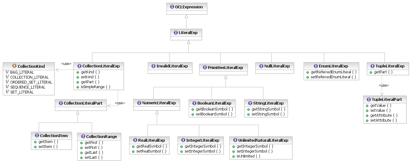

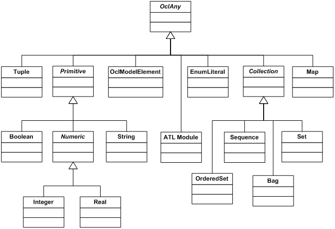

Is there any API of ATl that i can import in my java program, to generate ATL code. Like for example i want to create a rule, can i just instantiate MatchedRule class in ATL or LazyMatchedRule class in my java program.
Also how can I download OCL Expression API index.php/fa/21082/0/ and OCl primitive types API index.php/fa/21083/0/
I want Implementation of these classes, where can i find it.

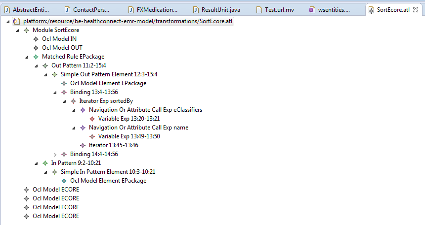

With ATL/EMFTVM installed, you can directly open an ATL file with the "Sample Reflective Ecore Model Editor":
  1. Right-click ATL file
  2. Open With -> Other...
  3. Sample Reflective Ecore Model Editor
Example:
-- @atlcompiler emftvm
-- @nsURI ECORE=http://www.eclipse.org/emf/2002/Ecore
-- Alphabetically sorts the contents of an Ecore model by name.
module SortEcore;
create OUT : ECORE refining IN : ECORE;
rule EPackage {
	from
		s : ECORE!EPackage
	to
		t : ECORE!EPackage (
			eClassifiers <- s.eClassifiers->sortedBy(e | e.name),
			eSubpackages <- s.eSubpackages->sortedBy(p | p.name)
opens as:
index.php/fa/21175/0/
  • Attachment: SortEcore.png
    (Size: 25.11KB, Downloaded 801 times)
