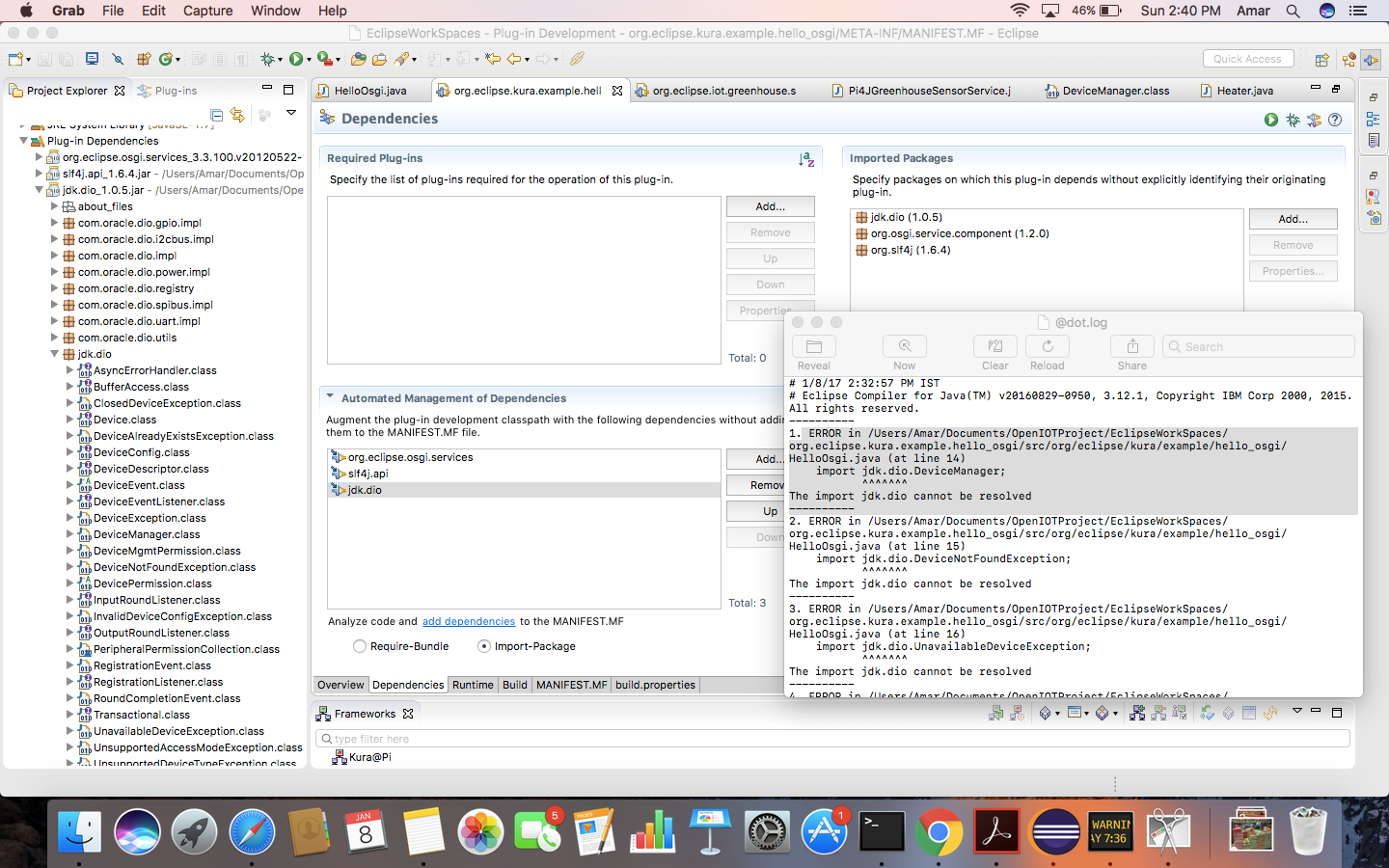

Re: JDK 8 support? (Error exporting bundle...) [message #1751333 is a reply to message #1633464] Sun, 08 January 2017 23:46 Go to previous messageGo to next message
I am facing this issue.
I am bound to use JDK 1.8, as I am using jdk.dio jar file, which is available only in JDK8.
As per this thread OSGI 3.8.1 does not support JDK 8. , and the latest version of Kura development workspace contains this OSGI 3.8.1 .
So how to upgrade this OSGI to latest version.
Any alternative, I can use jdk.dio jar ...
Re: JDK 8 support? (Error exporting bundle...) [message #1751334 is a reply to message #1633464] Sun, 08 January 2017 23:49 Go to previous messageGo to next message
The error:
org.eclipse.pde.container.feature: Bundle org.eclipse.kura.example.hello_osgi_1.0.0.qualifier failed to resolve.:
Missing Constraint: Bundle-RequiredExecutionEnvironment: JavaSE-1.8
Host plug-in JavaSE_0.0.0 has not been found.
Re: JDK 8 support? (Error exporting bundle...) [message #1751614 is a reply to message #1751334] Wed, 11 January 2017 17:39 Go to previous message
For clarification, there is no issue running Kura on JDK 8. The only limitation is that you cannot use Java 8 constructs within your application. To put another way, your Kura application has to be compatible with Java 7. This does not mean that you cannot run your application and Kura on Java 8. To get your application to work, simply remove "Bundle-RequiredExecutionEnvironment: JavaSE-1.8" from your MANIFEST.MF file. Assuming you are not using Java 8 specific code within your application.
Also, Kura already includes jdk.dio, is there a reason you need to use a separate Jar?
FWIW, we are moving to Java 8 (Equinox 3.11) in Kura v3.0.0. We hope to have a milestone release ready by the end of January and a full release ready by the end of March.
--Dave
