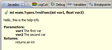

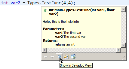

There is a feature in Eclipse JDT that is not in CDT, that gives a reasonable equivalent:
From the function hover, there is an option "show in Javadoc view". The doxygen help is then loaded into a panel and can be viewed as long as desired. It's also possible to assign a keystroke to this command "Show View (Javadoc)".
Example:
index.php/fa/12698/0/
index.php/fa/12699/0/
