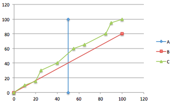

(I've also attached the spreadsheet I used so you can see how this was
constructed). However have struggled to figure out how I do the same
thing in BIRT. All my attempts to create this have failed as BIRT seems
to be built on the assumption that one of the axies is based on grouped
information.
If any one can recreate this in BIRT and show me how it is done I'd be
very grateful as my amateur attempts have failed.
Nigel

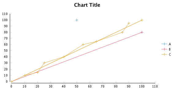

Re: Recreate excel xy graph [message #957862 is a reply to message #957644] Thu, 25 October 2012 10:51 Go to previous messageGo to next message
made a discovery looking around the chart gui that grouping was enabled
on the X axis data set under chart data. Now I get a result much close
to what I am seeking, apart from it now seems to ignore the sequence of
the C data series. See the attached image!
Nigel

Re: Recreate excel xy graph [message #958397 is a reply to message #953708] Thu, 25 October 2012 20:48 Go to previous messageGo to next message
Try this one. I sorted the values based on the x-axis field and also chose to connect missing values.
Re: Recreate excel xy graph [message #958835 is a reply to message #958397] Fri, 26 October 2012 04:49 Go to previous messageGo to next message
Thanks Michael!
That's got it working, I apreciate your help on this... it had me foxed :)
Re: Recreate excel xy graph [message #961073 is a reply to message #958835] Sat, 27 October 2012 22:00 Go to previous message
Not a problem! Smile
