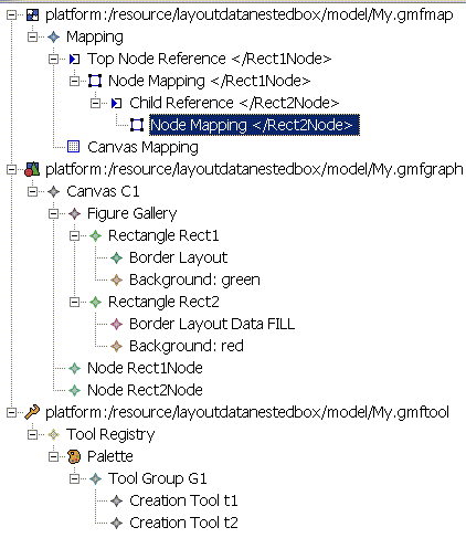

Re: Nested Rectangles and Layout [message #96211 is a reply to message #95351] Wed, 24 January 2007 13:50 Go to previous messageGo to next message
Guess, I do not understand your usecase and reason you need explicitly
defined child nodes if you merely use them as figures (iow, "All boxes
should have assigned nodes" makes me puzzled). As you .gmfmap screenshot
suggests, you expect to get Box1 with all nested nodes/figures using
Box1Creation tool. If all the nodes/figures are right there at the creation
time (moreover, they need GridLayoutData assigned), what's the purpose of
Rect2Node?
If your usecase is about creating Box2 inside Box1 on demand, than you might
need to tweak Box2's EditPart class, refreshBounds method. Alternatively,
you may use intermediate comparments for each child node (layout constraints
should be attached to compartment in this case).

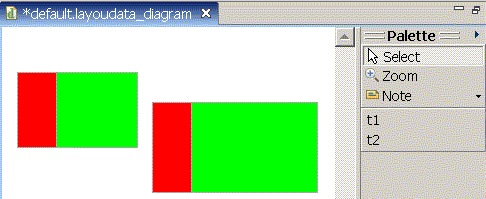

I've just ran simple GMF sample similar to what you described (two nested
boxes, layout), see attached screenshots. The only change I had to made was
Rect2NodeEditPart#refreshBounds to enforce proper layout data (not
XYLayout's Rectangle which is default for shape-kind children). However, I'm
not sure this is what you are trying to achieve.
Artem

Well, if Box2 is merely a grouping for other nodes, compartments are the
right choice.
XYLayout and ListLayout are most common use cases, hence the support.
Bugzilla is the forum to get some more ;)
