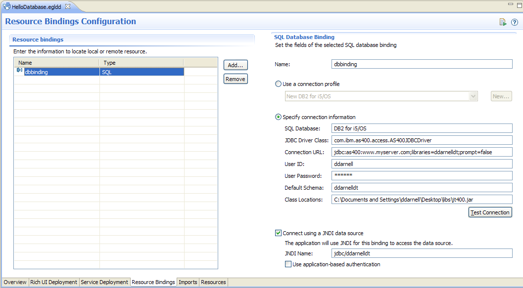

Attached screen shot is of my deployment descriptor. I did no manual JNDI/JDBC resource config on the Tomcat side ... just went with the context.xml as generated by the EDT tool in my deployable web project.

Re: JDBC driver error message from EGL on Tomcat 6 on iSeries [message #922918 is a reply to message #922251] Tue, 25 September 2012 09:03 Go to previous messageGo to next message
Thanks for the test project. I'll work on it, but first, a couple of quick questions:
Do you find it better to specify all the connection properties instead of using a Connection Profile? The Connection Profiles seem to have a more limited capability with connection properties (as I discuss in my other forum topic "Default schema is not used by iSeries DB2 connection profile")
Also, I noticed you entered a local path on your PC for the "Class Locations" field. How is that used, and should I change it to the iSeries location when deploying to the iSeries?
Thanks much for you help and hand-holding.
Shouldn't have to change the "class locations" entry for deployment. It's not part of what makes it to "context.xml" in the web project. Seems to only be used when running in the IDE.
As long as you drop jt400.jar into /lib under Tomcat on the IBM i then Tomcat should be happy when you deploy.
--Dan
[Updated on: Tue, 25 September 2012 14:00] by Moderator

jt400.jar
When I installed TC 7 and got the first success on the tutorial, I suddenly remembered that I had not copied the jt400.jar to the Tomcat /lib...that was weird. I discovered that the workbench is exporting the jt400.jar into the war file so it gets deployed in each app's WEB-INF/lib directory.
I did some more testing and found that TC 7 will run the apps correctly with jt400.jar in /lib or in WEB-INF/lib or in both (on both the iSeries and the PC). In fact, all of my tests on the PC and the iSeries returned the same results -- nice to see some consistency!
It seems the "Class locations" field in the Binding properties not only is used for classes in the IDE, it causes the jt400.jar file specified to be deployed to the web project and exported to the war file. I discovered that because I had different paths in the two projects pointing to two different versions of the jt400.jar, one left over from WDSc and the other supplied in EDT.
Leaving that field blank caused no jt400.jar to be deployed to the project or war. I like this as it lets the app server handle the jar file. However, is it better to have it in each app to avoid compatibility issues?
Leaving it blank causes problems with the connection in the IDE. Is there another setting to cause it to not be deployed and exported?
Well, thanks for your help and suggestions that got me this far. I can now move on to the next tutorial.
P.S. Once it was all working, I deleted all the jt400.jars and put the loader path in Tomcat to jt400Native. That worked too!
