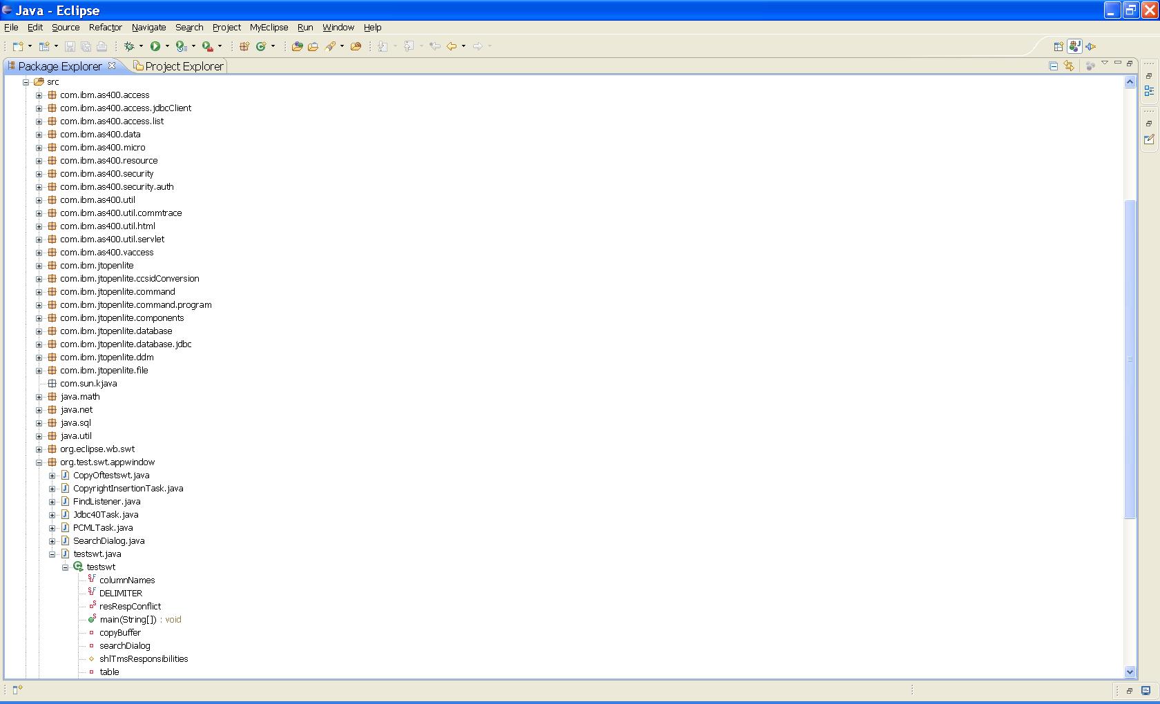

Re: java.lang.NoClassDefFoundError [message #903017 is a reply to message #902310] Tue, 21 August 2012 12:21 Go to previous messageGo to next message
I don't understand how it cannot exist. Class testswt shows as exiting under test.swt.
testswt is the .java I'm trying to run and org.test.swt.appwindow is the package testswt.java was placed in when I imported jt400.
All the jt400 imports were placed in packages within src.
Should I move the .javas to be under src?

Re: java.lang.NoClassDefFoundError [message #903031 is a reply to message #903017] Tue, 21 August 2012 13:06 Go to previous messageGo to next message
It increases the difficulty in communication when the one being
supported is doing the unexpected, in this case, failing to follow Java
naming convention. Without your illustration, one is tempted to see
org.test.swt.appwindow.testswt as a package and not a class. From the
illustration it's clear that your class is testswt and that it has a
main, which looks good as far as it goes (can't see the code to that
class, but void main( String[] ) looks okay.
Your ".javas" are already under src. These would be, notably, testswt.java.
It's the rest of the stuff, which we can't see, that's buried under
packages. Typically, JARs (if that's what they are and certainly I'd
expect what's under java.math, java.net, java.sql, etc.) are placed
elsewhere and bound to the project by way of then Java Build Path ->
Libraries dialog.
My advice (and if you add 35 cents to it it's enough to make a phone
call if you can find a pay phone) would be to find a tutorial on how to
set up an Eclipse project. I would suggest starting here:
http://www.vogella.com/eclipseide.html
