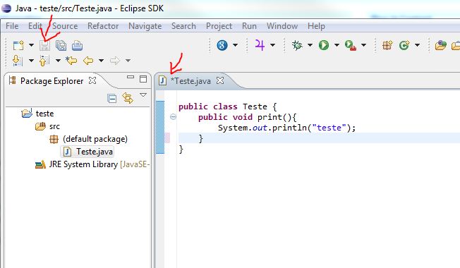

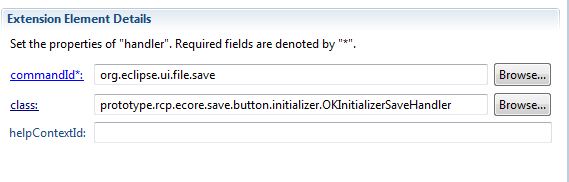

I need to run a routine everytime the "save button" is pressed. To do that, I created a handler to the org.eclipse.ui.file.save command (see extension element detains.JPG).
I'm able to launch an eclipse application, but the save button is not enable, even when the file is edited (see inactiveSaveButton.JPG).

Re: Inactive save button wiht new handler to save command [message #892453 is a reply to message #892305] Thu, 28 June 2012 05:41 Go to previous messageGo to next message
sounds like your handler is not enabled. Did you specify an enabledWhen expression with your handler extension?
