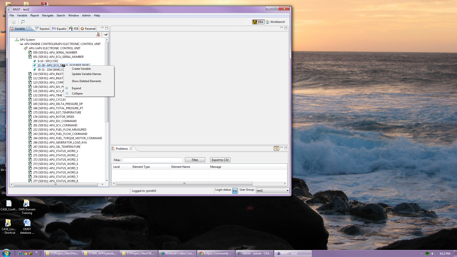

Re: Left Click operation on a pop up menu [message #1644221 is a reply to message #886158] Sun, 01 March 2015 19:26 Go to previous messageGo to next message
I am having a similar issue. I have looked at the other threads, as well as the cheat sheet, and my test continues to die trying to select the context menu item. I am running Jubula 8.1 stand alone against an RCP application. I've received a variety of error messages back, ranging from "Timeout received before confirming the posted event" to "Context Menu not found". I am not sure why it fails to find the menu option.
I have also tried both select by textpath and select by index, hoping one would work, but no luck.
Attached is the screenshot from Jubula. It appears to be getting the context menu to display, but fails to select anything. The cursor never moves onto the menu, so nothing ever gets selected. I tried a few times to export the test results details, but the tool never output anything to the paths provided.
Any help or suggestions are appreciated!

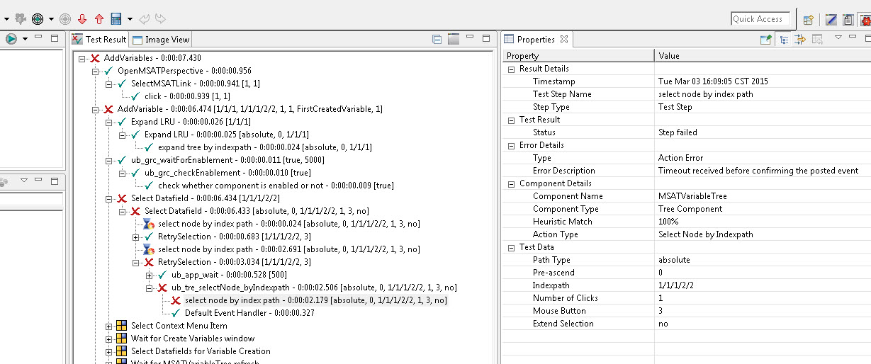

Re: Left Click operation on a pop up menu [message #1648374 is a reply to message #1645582] Tue, 03 March 2015 17:22 Go to previous messageGo to next message
Hi Alex,
Thanks for the reply. In response to your questions:
- select from the tree
- select from context menu
Is that correct? - yes, this is correct
Without seeing the test results, it's hard to guess what might be the cause, but here are some suspicions:
- Which mouse button are you using to open the context menu? It should be '3' - I have tried both 1 and 3, with no change in results
- Which actions are you using exactly? - ub_tre_selectNode_byIndexpath and I have tried both ub_grc_selectCOntextMenuEntry_byTextpath and ub_grc_selectContextMenuEntry_byIndexpath
- Which version of Java are you using, and which version of Eclipse (and is it pure or with compatibility layer)? - I believe I am using Java 1.6 (though with multiple versions installed, I'm not sure how I know for sure. Running from the cmd window, java -version returns 1.8.0_31) At a minimum, I know we are relying only on 1.6 functionality, so either using a 1.6 JVM or a new JVM with 1.6 compatibility. Eclipse version the AUT was built with is Helios (3.6.2), and the AUT is built for a 64-bit JVM.
I've attached a screenshot of the test results, since I am still unable to export them (I tried changing directories, but it didn't help, and no, there are no spaces in the path name).
I'm running on a 64-bit Windows 7 platform and am using the embedded AUT agent.
Please let me know if you need more information.
Thanks!
Becky
Re: Left Click operation on a pop up menu [message #1649168 is a reply to message #1648374] Wed, 04 March 2015 02:28 Go to previous messageGo to next message
Thanks for the information and the image. I see what is happening now.
The test isn't getting as far as the context menu selection in the first place - it's failing on the select from the tree.
My suspicion is the following: the select from the tree is configured to have mouse button '3'. To perform the selection in the tree, you should use mouse button '1'. The action for the context menu is the one that will require button '3'.
Since it is the tree selection that is failing, I have some more questions:
- are you able to select anything from this tree (by index or by textpath)? What happens if you just try to select the root node or a less-deep path?
- are you able to select from other trees in the application or do you have similar problems?
- can you attach the rc_rcp log extract for the exact time that the selection takes place and fails?
- if there is any way that you can provide a small example of the tree as a built application, then I can try it out here as well.

Re: Left Click operation on a pop up menu [message #1649838 is a reply to message #1649168] Wed, 04 March 2015 09:32 Go to previous messageGo to next message
Hi Alex,
I've run into issues with the tree selection because it is timing out while loading the tree. I was going to look into this more, but was able to work around the issue by manually accessing data in the AUT before running the test. Is there a way to configure a timeout? I've tried adding the "DGD_IGNORE_TIMEOUT=true" to the System Environment Variables portion of the AUT launch configuration, but it didn't seem to make a difference.
If you look at the image screenshot, you can see that the tree item is selected and that the context menu gets displayed, but that nothing in the context menu itself ever gets selected. If the tree selection were the problem, I wouldn't have expected to see a tree item selected. The first test I wrote (which I also ran into problems with) also selected an item in the same tree and was able to select it and open an editor based on the selection.
