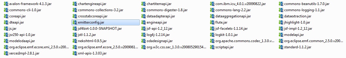

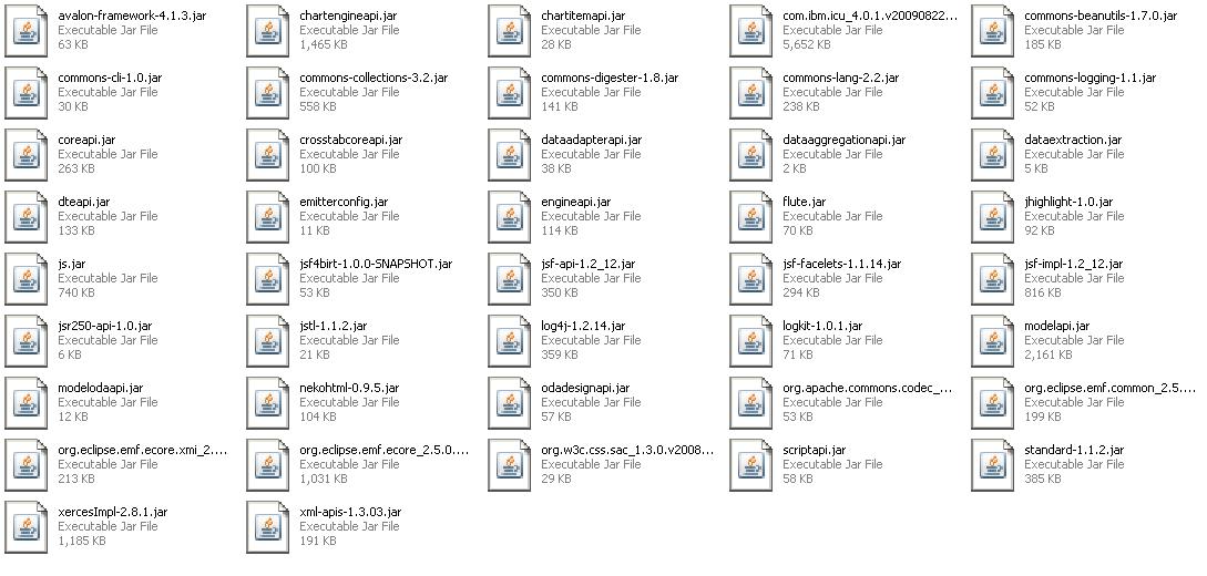

I am also adding the screen shots of the jars added since module size exceeds the permitted file size.

5. The list of required jars are mentioned in the screen attached with this post.
(Downloading the dummy module of jsf4birt from exadel website will be helpful).
