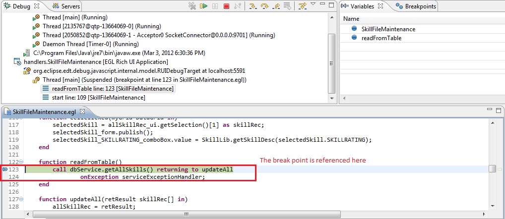

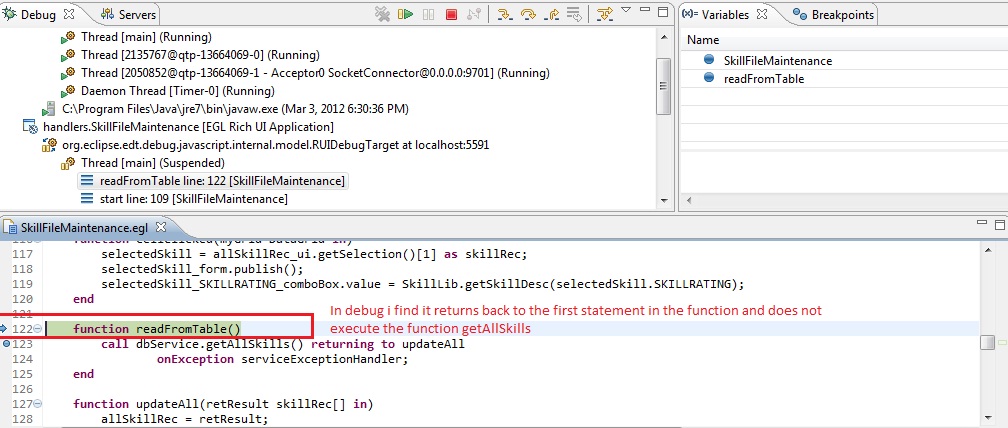

Hi Justin,
Please find attached the handler source and also the screen shot of the issue.i have done the coding using the 0.7 version.Thanks
function start()
readFromTable();
end
function readFromTable()
call dbService.getAllSkills() returning to updateAll
onException serviceExceptionHandler;
end
For some reason or the other the pointer returns back to Start() function in debug and the dbService is not invoked.The connection and all other details are fine.Thanks
Karthik

Re: Preview Mode issue [message #813751 is a reply to message #812243] Mon, 05 March 2012 12:08 Go to previous messageGo to next message

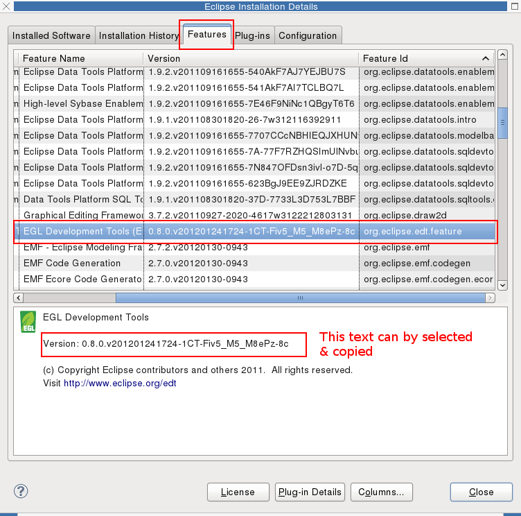

Okay, so I've tried 0.8 M1, 0.8 M2, and a recent nightly build, but I cannot reproduce this. Can you export your project as a zip file and attach it (File > Export > General > Archive File)? You can remove any sensitive data like passwords in your deployment descriptor beforehand. This will let me used the exact generated code that you're running.
Also, please go to Help > About > Installation Details > Features, click on the "Feature Id" column to sort it, find id "org.eclipse.edt.feature", and paste its version here. See my attached screenshot for an example from the M1 build. This will let me know exactly which build is being used so I can better match your environment.
And, to clear one thing up that might be confusing you: When you run a call statement from a RUI application to invoke a service, it is an asynchronous call. So we kick off the call and then the RUI application will immediately continue executing its code. A "step into" on the call statement does not step into the service, because the service is a separate process and not running in the browser. That's why you see it move to the next line of the RUI function instead of waiting for the service invocation to finish. Tip: If you want to debug your service function, just put a breakpoint in it.
The callback function in your RUI application will be run once the service has finished processing. JavaScript is single-threaded so only one piece of code can be running at a time, therefore your callback won't be invoked until nothing else is running.
-Justin

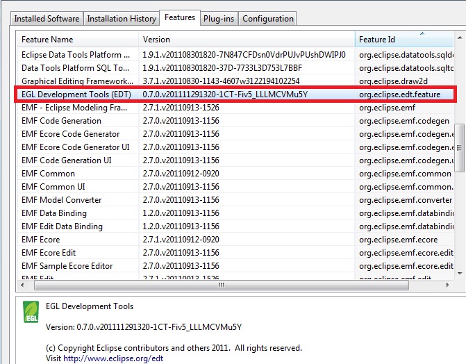

Thanks for the screenshot. Can you try emailing the project to me? jspadea {at} us {dot} ibm {dot} com
Also, have you been changing versions of EDT? The screenshot shows it's 0.7.0, but some of the previous posts have sounded like 0.8.0 builds based on error messages.
