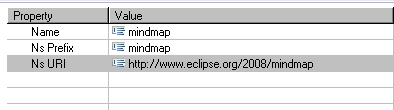

i've created my .ecore with a .ecore_diagram and, i've set those informations (like you can se in this image)
NS Prefix:mindmap
NS URI: h_t_t_p://www.eclipse.org/2008/mindmap
By valid uri what do you mean? the uri must have some kind of standard structure or i can choose something random like h_t_t_p://www.uri.com/mindmap??

Re: [Xpand] import issue [message #766731 is a reply to message #766668] Fri, 16 December 2011 05:33 Go to previous messageGo to next message
The NS URI just needs to be unique. Question is if the URIs *in* the ecore XMI are valid. Usually they are, so don't be confused so much from my post. It is just that I saw Ecore files with references where the reference URIs were not valid, which leads to such an error in the editor.
