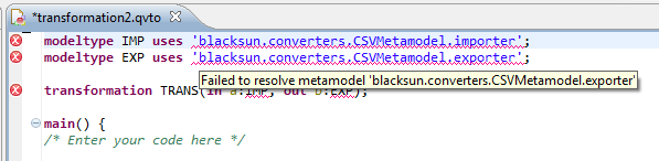

- when QVT editor with file (which uses these metamodels) was opened before user chose to register the metamodels (popup-menu), the QVTo plugin do not see
index.php/fa/3939/0/
these metamodels, even if they are in Registry (only closing the editor and then restarting the Eclipse works)

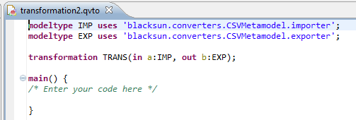

- when no QVT editor was opened and user chose to register the metamodels and THEN opened the QVT file which uses these metamodels - everything works perfectly
index.php/fa/3938/0/

Some tools search the workspace for models. Sometimes this is helpful,
usually it is inefficient and often confusing.
Other tools like QVTo expect you to identify the models.
If you want to do this dynamically put the relevant entries in the
ResourceSet's package registry that you share with QVTo.
Ed Willink
