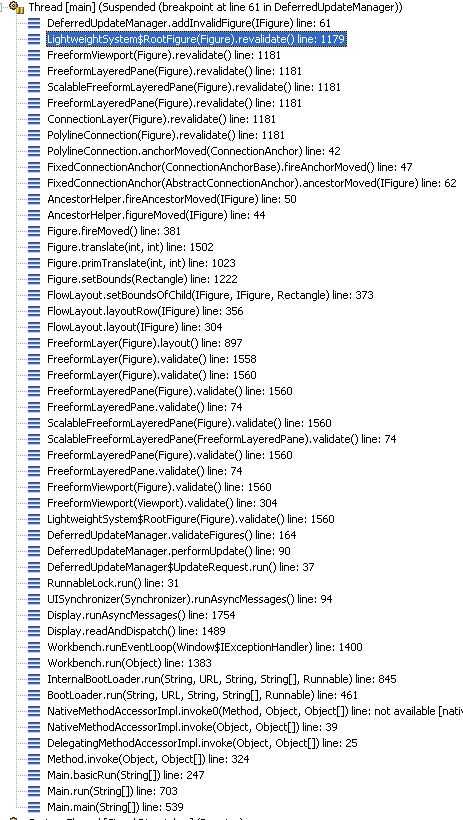

Randy Can you look at the attached stack trace?
I'm trying to add zoom support and followed the logic example to add a free
form editpart to do so. It works great some of the time but other times, the
code gets into an endless loop after a change in zoom. I suspended the
program in the middle of one of these loops. Can you look at the stack trace
and see if that looks about right?
How would you diagnose this problem?
Ray
  • Attachment: Clipboard.jpg
    (Size: 93.18KB, Downloaded 174 times)

Do you have a FlowLayout set as the Layout for a Freeform layer? This
doesn't work, only FreeformXYLayout works. The reason is that a freeform
figure can extend in all directions, as needed by the location of its
children. So, the top-left corner of a freeform figure is a function of the
location of the children. But, with flowlayout, the locations of the
children are a function of the top-left corner of the container (the
freeform layer).
Do you currently allow the user to drag things into negative x or y
coordinates? Or, does you automatic layout ever place things in negative x
coordinates (for really large flows, perhaps). If not, you don't need
freeform anything.

If you look at the difference between XYLayout and FreeformXYLayout, you
will get an idea.
Basically, you want a FlowLayout which, instead of position children
relative to its getClientArea().getLocation(), you position them relative to
0,0, all the time.
But then this begs the question, why use Freeform at all? It sounds like
you are just using it for its Zoom support.

Zooming support is the whole reason I got into this mess in the first place
:-) We do need zooming support.
The way I added zooming support is to set the root edit part to be
ScaleableFreeformRootEditPart as per logic example. As I said, that was
enough to cause the infinite loops in our otherwise well behaved editor.
So if I can extropolate, I should then modify/subclass FlowLayout to force
the position of them to relative to 0,0????? That would be enough to solve
the problem? Please say yes :)
Ray
> freeform layer).
I now have a similar problem. I am using FreeformLayout in a
FreeformLayer and the system goes into an endless loop when I try to
zoom. I believe since the previous post FreeformLayout has replaced
FreeformXYLayout, but I could be wrong.
By not setting the layout manager, I avoid this problem, but of course,
nothing is positioned properly within the diagram. I have tried also
using XYLayout, but I fall into the same endless loop.
Any thoughts?
Nick

The problem only occurs when I have connections in my diagram. Any
other sort of figures work just fine with zoom.
Re: zooming support endless loop [message #196241 is a reply to message #196226] Fri, 16 September 2005 20:27 Go to previous messageGo to next message
I have found that it infinitely loops in the for loop of the
DeferredUpdateManager.validateFigures() method.
Re: zooming support endless loop [message #196249 is a reply to message #196226] Fri, 16 September 2005 20:33 Go to previous messageGo to next message
and I am sure my answer lies in the following newsgroup thread...
subject: stuck in endless loop in DeferredUpdateManager
from: Jason Woods
date: 10/13/2003
Re: zooming support endless loop [message #196256 is a reply to message #196241] Fri, 16 September 2005 21:18 Go to previous message
It appears that it was caused by a buggy Locator that I had implemented.
I have found that RelativeLocator with the proper constant provides
