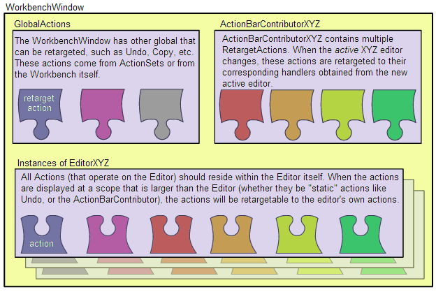

The action changes were mentioned on the GEF plan. Our action organization
is much closer to AbstractTextEditor now. The main difference is that we
don't require the EditorPart to implement any special interface. We just
ask it for its Actions using getAdapter(ActionRegistry.class). This allows
you to use MultiPageEditorPart or your own Editor implementation.
The EditorActionBarContributor contains RetargetActions that get retarget to
their corrsponding handlers from the EditorPart. This allows the Outline
View or other views to hook into your retargetactions. Take a look at the
attached image.
