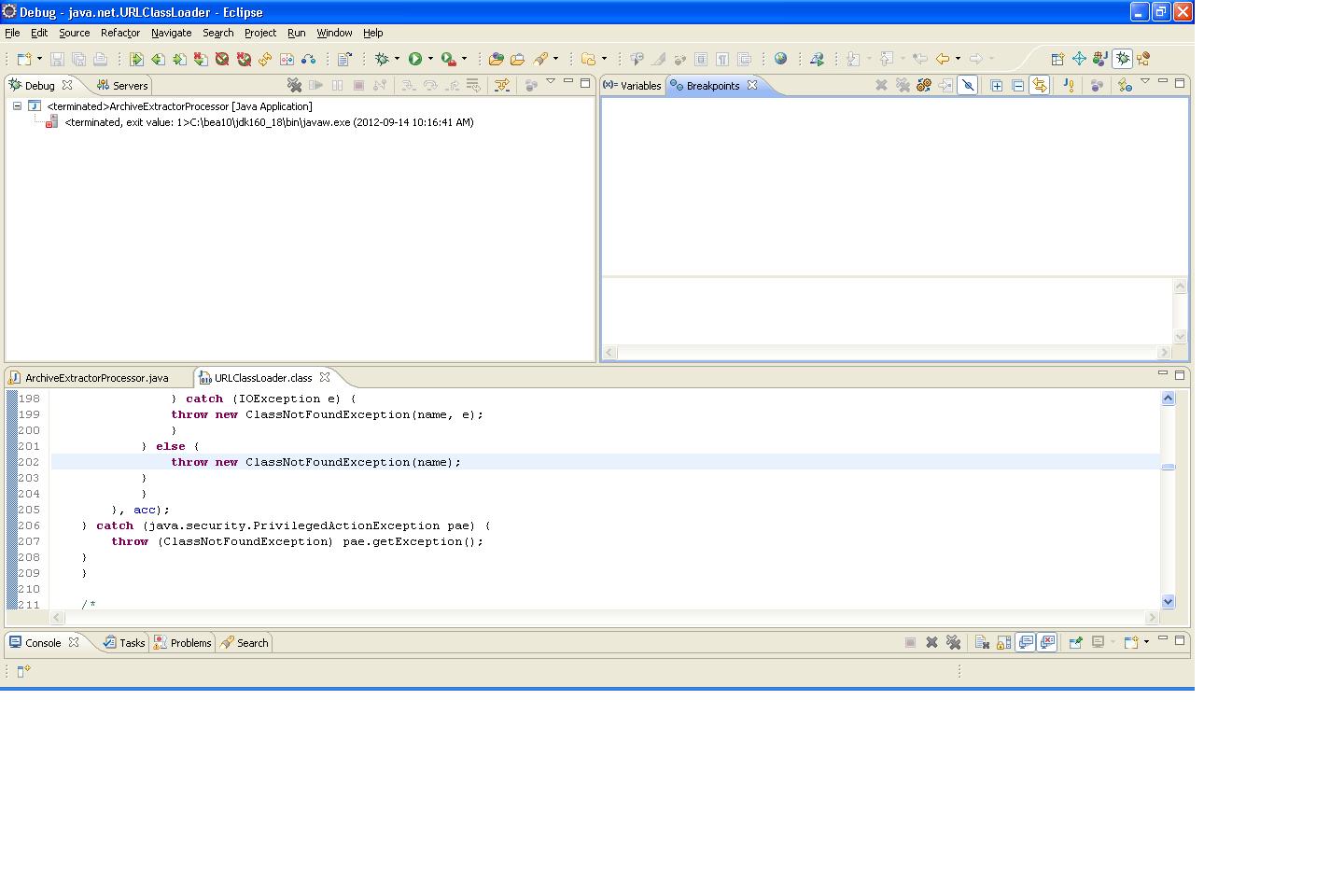

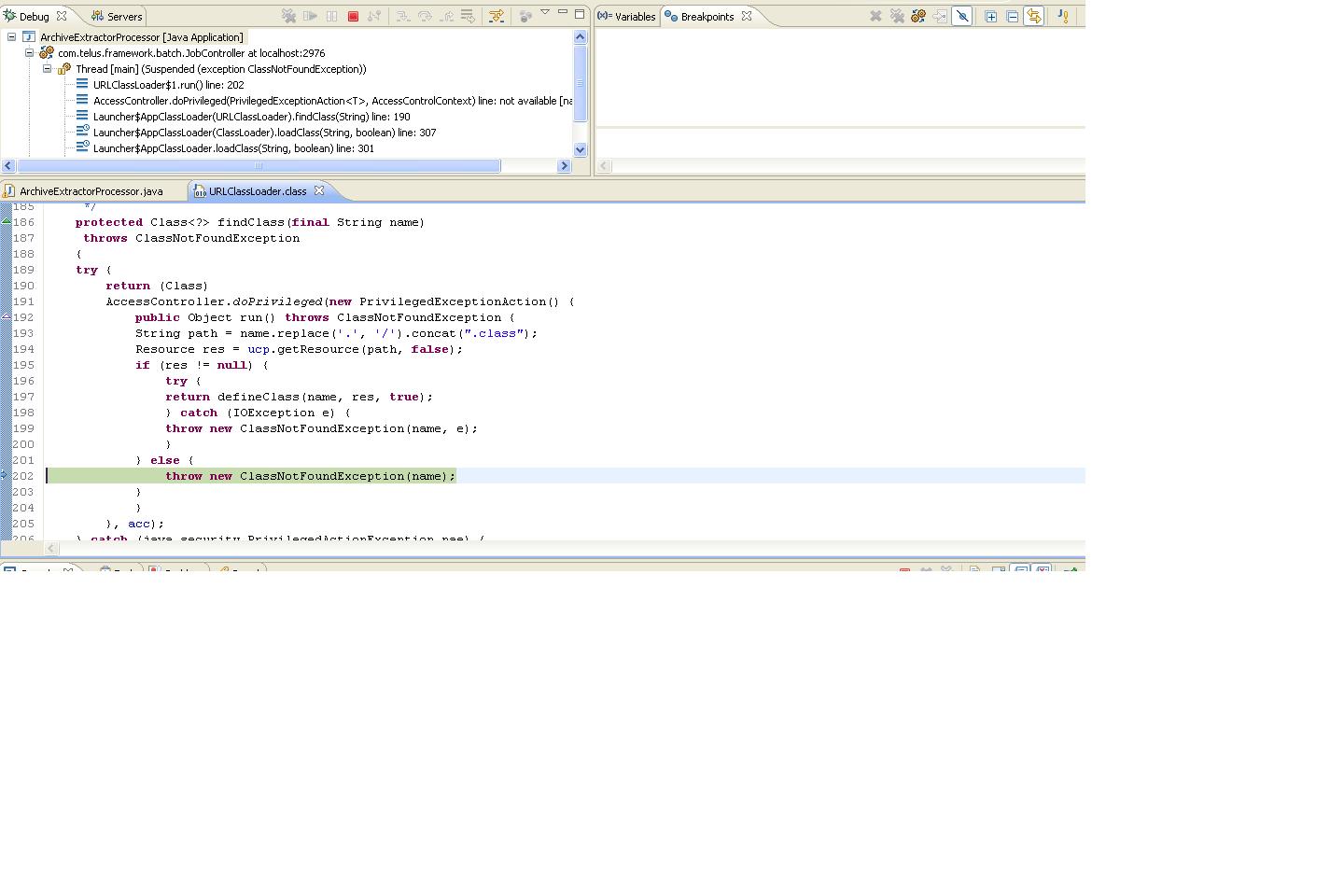

If try to run/debug my application, I am getting this errors
debug cinfiguration
Thread [main] (Suspended (exception ClassNotFoundException))
	URLClassLoader$1.run() line: 202
	AccessController.doPrivileged(PrivilegedExceptionAction<T>, AccessControlContext) line: not available [native method]
	Launcher$AppClassLoader(URLClassLoader).findClass(String) line: 190
	Launcher$AppClassLoader(ClassLoader).loadClass(String, boolean) line: 307
	Launcher$AppClassLoader.loadClass(String, boolean) line: 301
	Launcher$AppClassLoader(ClassLoader).loadClass(String) line: 248
I removed all breakpoints, still I am getting this error
run configuration
<terminated>ArchiveExtractorProcessor [Java Application]
	<terminated, exit value: 1>C:\bea10\jdk160_18\bin\javaw.exe (2012-09-13 11:52:25 AM)

Re: Eclipse debug error [message #913057 is a reply to message #912711] Fri, 14 September 2012 13:20 Go to previous messageGo to next message
i have class file in jar com.t.framework.batch.JobController , this class is entered in Main Class entry text box
arguments are as follows
program arguments
jobdefinition/archiveExtractor.jdef FORCE_FROM_STEP01
vm arguments
-DAPP_HOME=C:\Documents and Settings\x12\t855_vox_3.0_dev\vobs\vox_source\vox
-DDATA_HOME=C:\Documents and Settings\x12\t855_vox_3.0_dev\vobs\vox_source\vox
-DENV=local
-DLEVEL1_SHORTNAME="vx"
-DLEVEL2_SHORTNAME="ae"
gvdf
i emptied breakpoints in break point view
i can run hello world class file with main class, getting result too..
sometimes it get terminated
but when i run using the option debug configuration
it throews the following error , i m not able to do debugging further, but not getting terminated. i have to terminate it manually.
	com.telus.framework.batch.JobController at localhost:2976
	C:\bea10\jdk160_18\bin\javaw.exe (2012-09-14 10:21:31 AM)
[Updated on: Fri, 14 September 2012 13:27] by Moderator
Re: Eclipse debug error [message #913296 is a reply to message #913057] Sat, 15 September 2012 03:10 Go to previous messageGo to next message
Feritz,
I think this is influenced by Window->Preferences->Java->Debug, i.e.,
Suspend Execution on uncaught exception.

Re: Eclipse debug error [message #1726205 is a reply to message #555861] Thu, 10 March 2016 09:21 Go to previous messageGo to next message
Hello everyone:
I am facing prob while going to debug mode. It gives the following error. i have done everything to figure out but unfortunately i did not figured out. Please help me , how to figure out this prob..
"No source available for "0x9e0c8""
