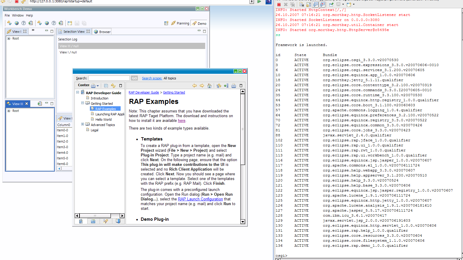

I guess you mean the eclipse help application, since context sensitive help
currently is not supported in RAP. In fact it seems not to be a big deal to
include the original eclipse help into an RAP application. I just did a test
running it in the demo workbench implementation with the RAP help contents
and got it to work quite fast.
The RAP target is missing the help stuff, so I took the org.eclipse.help,
org.eclipse.help.appserver, org.eclipse.help.base and
org.eclipse.help.webapp and the bundles that are needed to resolve the
dependencies of those bundles from a 3.3.0 eclipse installation. I
additionally included the rap help bundle and the bundles it depends on.
Note: I used the the validate functionality of the launcher to check which
bundles are missing.
After that I created an action in
DemoActionBarAdvisor#makeActions(IWorkbenchWindow):
helpContent = new Action() {
public void run() {
String helpURL = "http://{0}:{1}/index.jsp";
Object[] param = new Object[]{
RWT.getRequest().getServerName(),
String.valueOf( RWT.getRequest().getServerPort() )
Shell shell = new Shell( Display.getDefault() );
shell.setLayout( new FillLayout() );
Browser brwsr = new Browser( shell, SWT.NONE );
shell.setBounds( 20, 20, 400, 400 );
brwsr.setUrl( MessageFormat.format( helpURL, param ) );
shell.open();
helpContent.setText( "Help Contents" );
helpContent.setId( "org.eclipse.rap.demo.helpContent" );
helpContent.setImageDescriptor( helpActionImage );
register( helpContent );
and added it to the menu in DemoActionBarAdvisour#fillMenuBar(IMenuManager).
After launching the application the help system showed up in its own shell
by activating the Help -> Help Contents menu entry. Hope that works for you
too!
Ciao
Frank

Re: Help on Eclipse Help System [message #54717 is a reply to message #54661] Tue, 23 October 2007 10:36 Go to previous messageGo to next message
Originally posted by: fappel.innoopract.com
I think you're looking for something like the BaseHelpSystem in
org.eclipse.help.base - but unfortunately this is internal...
Just one thing: I don't have to run an extra server with infocenter
installed. It is embedded in the RAP application that I launch. I only have
to create an access URL since I have to set the property of the browser
widget. The server and port address is the same as the one of the RAP
application. I simply address another servlet and that's the same what RCP
is doing.
Ciao
Frank

Re: Help on Eclipse Help System [message #55571 is a reply to message #55273] Fri, 26 October 2007 01:22 Go to previous messageGo to next message
the rap help bundle is in the RAP-CVS (org.eclipse.rap.help). It's just the
RAP help, which is delivered with the tooling feature (It's the same that's
available at
http://help.eclipse.org/help33/index.jsp?topic=/org.eclipse. rap.help/help/html/intro.html). I
just mentioned this to explain which help content I used to play around
with.
I attached a screenshot that may makes thinks more clear. It shows the
integrated help on the left and the activated bundles on the right.
Ciao
Frank

  • Attachment: raphelp.png
    (Size: 166.79KB, Downloaded 264 times)
> public void run() {
> shell.open();
> too!
