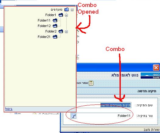

Is there a control in SWT / JFACE similar to Drop Down Tree View in .NET?
It is a drop down that opens a view of a tree without the leaves.
See image untitled.JPG - this is an image of my tree with folders and
various appplications as leaves.
See image untitled1.JPG - this is an image of my drop down tree view. The
Combo points to a the part which you click on to open the combo, and you can
see how the combo looks like when it is opened. It opens a panel with a tree
view where you only see the structure of the tree (not including the tree
leaves). This allows you to select a place on the structure of the tree.
If anyone knows of a similar control I would love to know. Or of how an idea
of how to implement this.

Take a look at AbstractCombo in the Nebula project's
org.eclipse.nebula.widgets.cdatetime bundle.
Wayne
