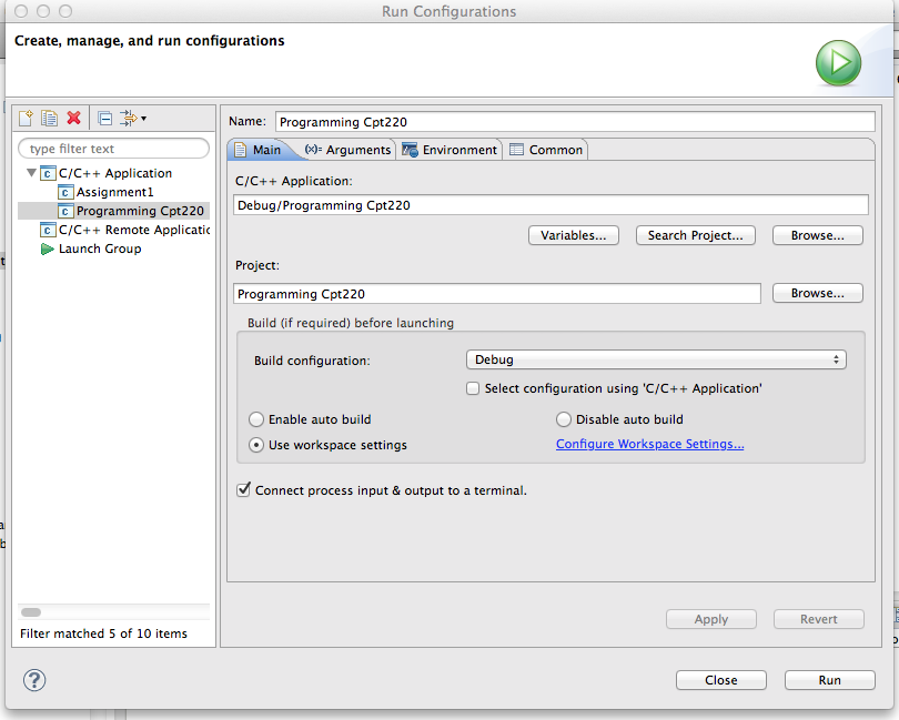

I just figured it out.
In the launch configuration's main tab, you have to select the option at
the bottom that says "Connect process input_output to a terminal"
I can reproduce your problem when I don't have that option checked.
Once you try this, make sure you see the correct console by using the
drop-down arrow in the console view. You want to use the console created
for your application to type your input.
Marc

Marc,
Thank you for your response.
In my Main tab on the Debug Configurations dialog, the "Connect process
input output to a terminal" option is checked by default and grayed out.
I'm using the MinGW tool chain with my setup and I have four options for
choosing the debugger under the Debugger tab:
It is strange that I can reproduce your error by unchecking this option.

Re: Debugger issues with input functions [message #1023429 is a reply to message #236381] Sun, 24 March 2013 03:10 Go to previous messageGo to next message
Eclipse was hanging for me when pressing CNTL + D when running a program that used EOF.
Go to Run-> Run configurations uncheck Connect process input & output to a terminal.
After posting this I found that if there is a print statement it won't print any of them till you press CNTRL + D...?
This sort of helps though not entirely.

Re: Debugger issues with input functions [message #1023809 is a reply to message #1023429] Mon, 25 March 2013 03:59 Go to previous message
Gerard Grundy wrote on Sun, 24 March 2013 08:10
Yours Sincerely,
Gerard Grundy
There are some open bugs with respect to EOF and debug console.
https://bugs.eclipse.org/bugs/show_bug.cgi?id=159803
