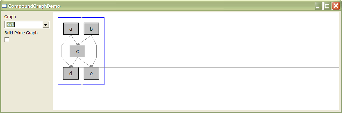

Hi All,
The following code which uses CompoundDirectedGraphLayout produces the
layout captured in the attached Compound.png. As you can see one of the
Edges inappropriately shoots out to the side.
This equivalent graph when laid out using DirectedGraphLayout does not have
this problem (e.g., see the attached "Not Compound.png" and the code that
produced it included below).
Am I doing anything wrong here? I'm using 3.2M5a.
Thanks for any help,
Rick

Re: CompoundDirectedGraphLayout creates Edge that shoots out to the side [message #216704 is a reply to message #216638] Tue, 23 May 2006 13:40 Go to previous message
Please test using the latest release candidate, then open a bugzilla if it
is still reproducible.
