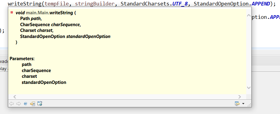

This is what is shown in version: 2024-06 (4.32)
index.php/fa/45120/0/
Much better.....
