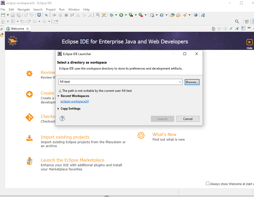

i work for a school where eclipse is used during education for a long time. It was always possible to open workspace on a network-folder like user home.
Now when I start eclipse and want to open workspace there, then comes "The path is not writable by the current user".
I think it could be a security preference from the new eclipse or a java security problem.
Does anybody have an idea what happened and what i can do because the students have to work on the server during exams.

first some details. The last release we had before this problem was 2021-12. Now with release 2024-06 its not possible to choose workspace on this network drive, but if i change the shortcut from ....eclipse.exe to ....eclipse.exe -data L:\test (where L: is the home drive) and eclipse can write on it. But if i choose switch workspace to another folder on this drive, it's still the same "path not writable by current user"?!

The logic was changed during the 2024-03 release cycle and now calls this method to test:
https://github.com/eclipse-platform/eclipse.platform.ui/blob/e3628a3a67c44771465d7d317b3424920c425090/bundles/org.eclipse.ui.ide/src/org/eclipse/ui/internal/ide/ChooseWorkspaceDialog.java#L491-L504
I suggest you open an issue here ASAP:
https://github.com/eclipse-platform/eclipse.platform.ui/issues
In the ideal world, you would write a small class with exactly the method above copied into it and test the behavior that you see for your path.
For me I tried this:
package test;
import java.nio.file.Files;
import java.nio.file.Path;
public class Test {
		isWritable(Path.of("D:\\test"));
	private static boolean isWritable(Path path) {
		if (Files.exists(path)) {
			return Files.isWritable(path);
		Path parent = path.getParent();
		if (parent != null) {
			return isWritable(parent);
		return true;
And apparently I do have write access to D:\.
Does it help in your case if you make sure the folder is created first?

As I understand it, the dialog will show the problem message but the OK button is not disabled.
