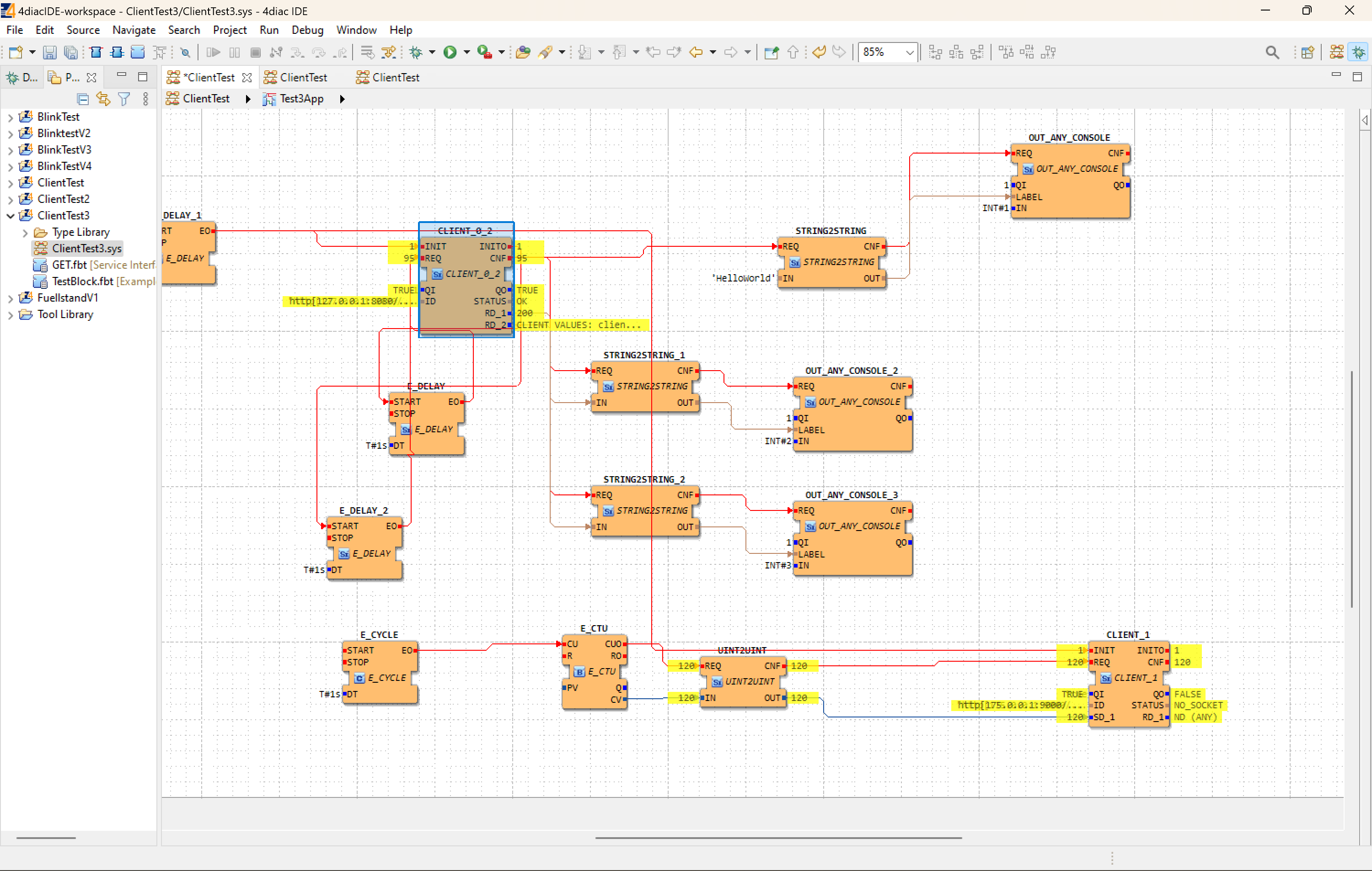

Re: Client with http-server [message #1866825 is a reply to message #1866816] Fri, 07 June 2024 10:36 Go to previous messageGo to next message

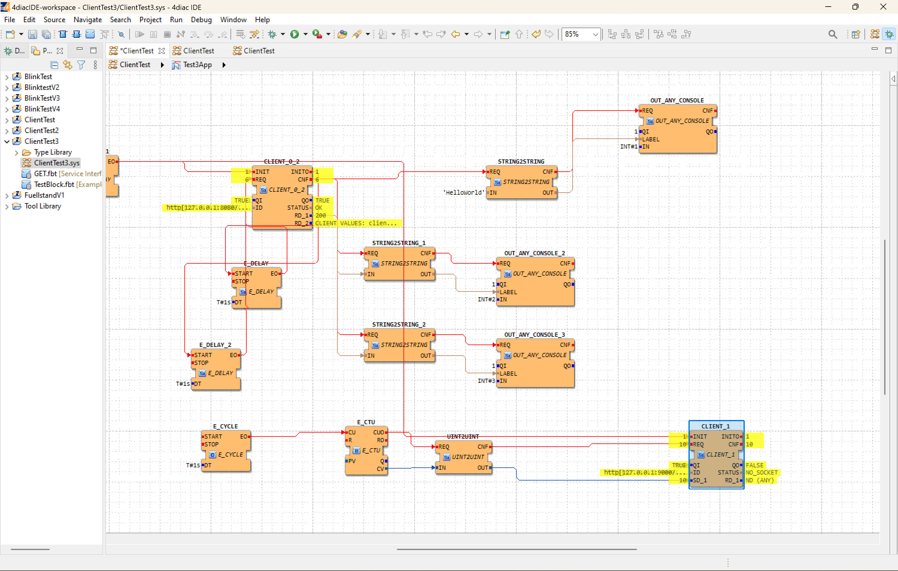

I could successfully build a get connection to a http-server.
But PUT or POST isn't working at the moment. My Server runs local (127.0.0.1) on PORT:9000 and I used on of the examples so that my ID is:
"http[127.0.0.1:9000/put;PUT;application/json]
I used from the Type Libary the Client_1 FB.
Thanks for the help

Re: Client with http-server [message #1866828 is a reply to message #1866816] Fri, 07 June 2024 10:38 Go to previous messageGo to next message
tried different IP-address so in my screenshot was the wrong one
I corrected the address back to 127.0.0.1 and the problem is still existing

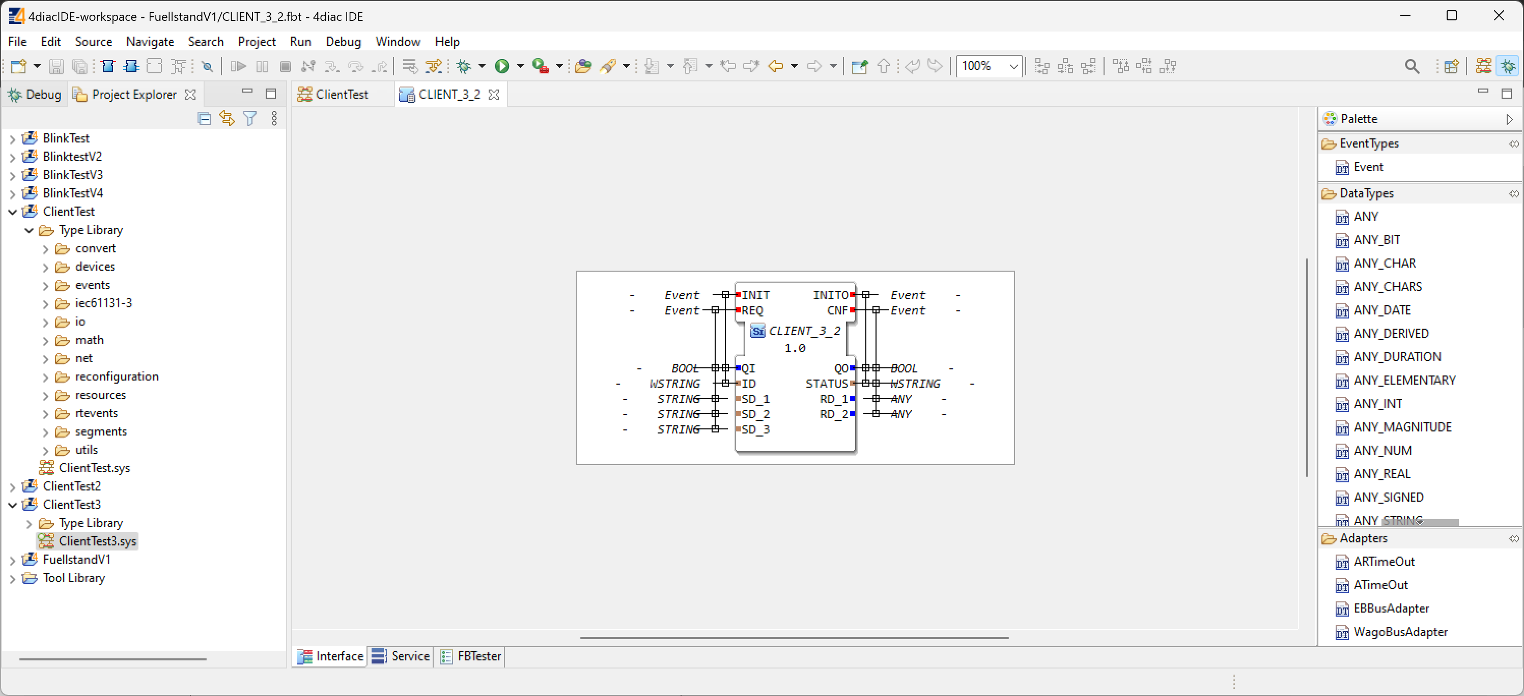

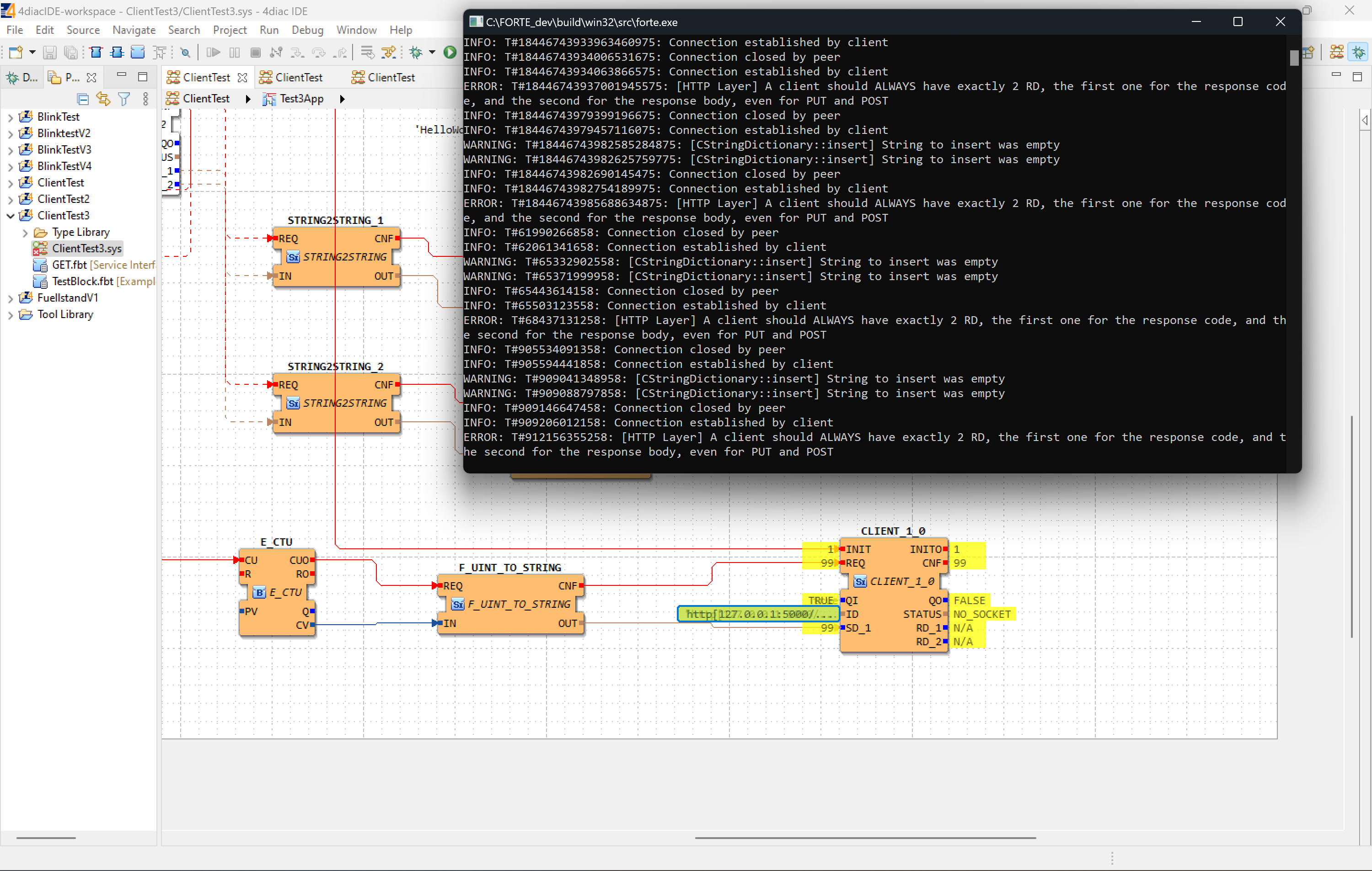

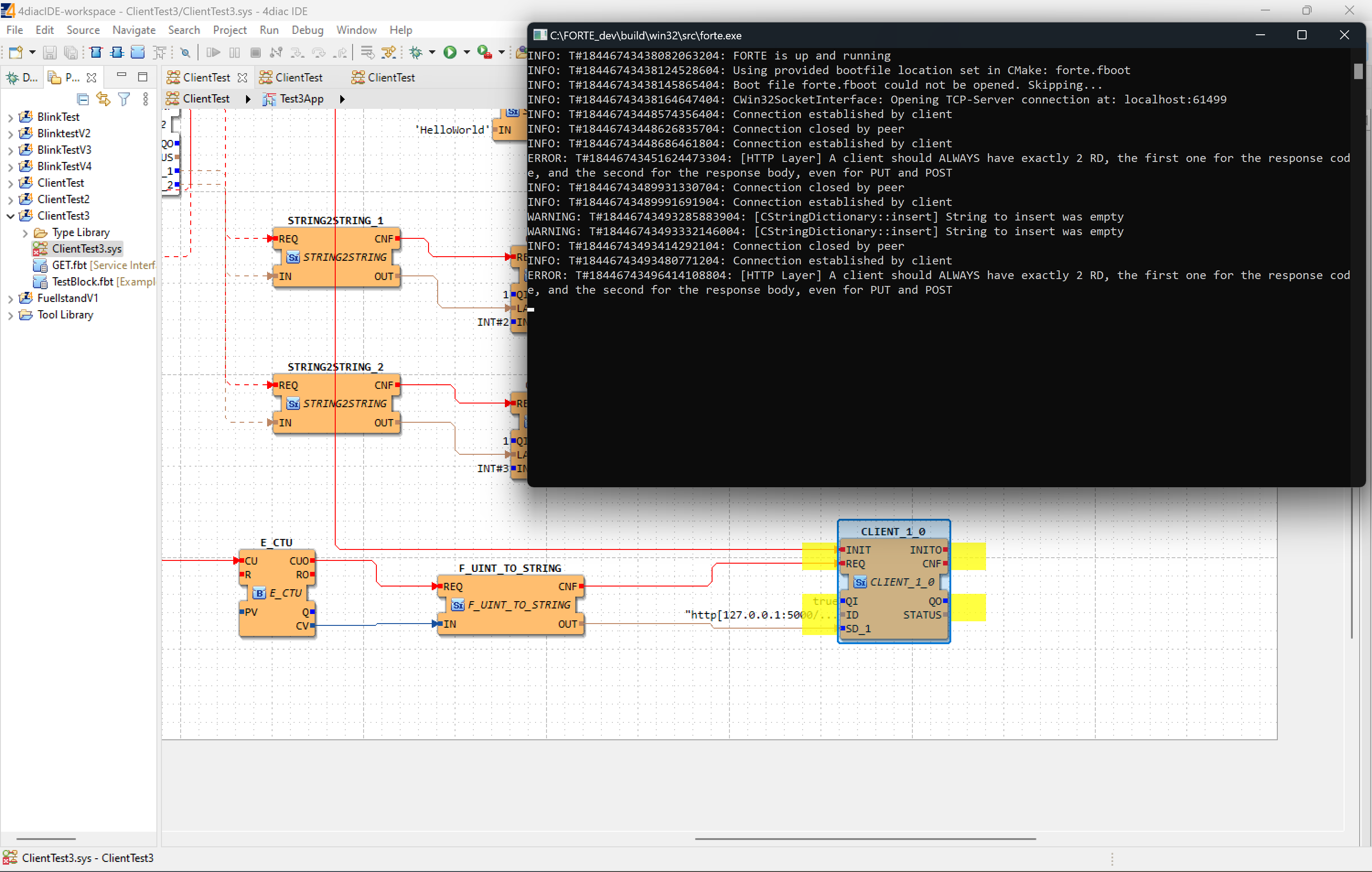

Re: Client with http-server [message #1866843 is a reply to message #1866831] Sat, 08 June 2024 22:50 Go to previous messageGo to next message
I tried a configuration with and without RDs.
My Forte shows like in the .png that every client needs two RDs.
When I stop the program I get the error that the string to insert was empty.
I don't understand my mistake.
Thanks for your help and tips
Re: Client with http-server [message #1866852 is a reply to message #1866843] Sun, 09 June 2024 05:12 Go to previous messageGo to next message
From the 4diac FORTE output I assume that you are using the develop branch for 4diac FORTE. AFAIR Monika did some improvements on the HTTP layer for that. She also updated and fixed the documentation. The new documentation can be found here: https://github.com/eclipse-4diac/4diac-documentation/blob/main/src/communication/http.adoc
This new documentation is also already part of the 4diac IDE documentation. However not yet on the web page. The reason for that is that we are currently reworking the web-page and changing the documentation on the old on is not really worth it.

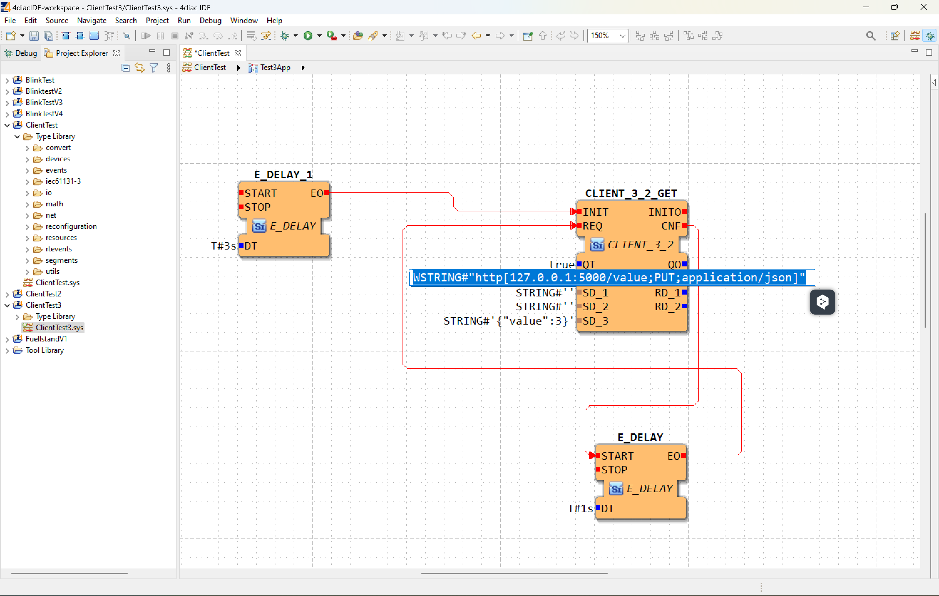

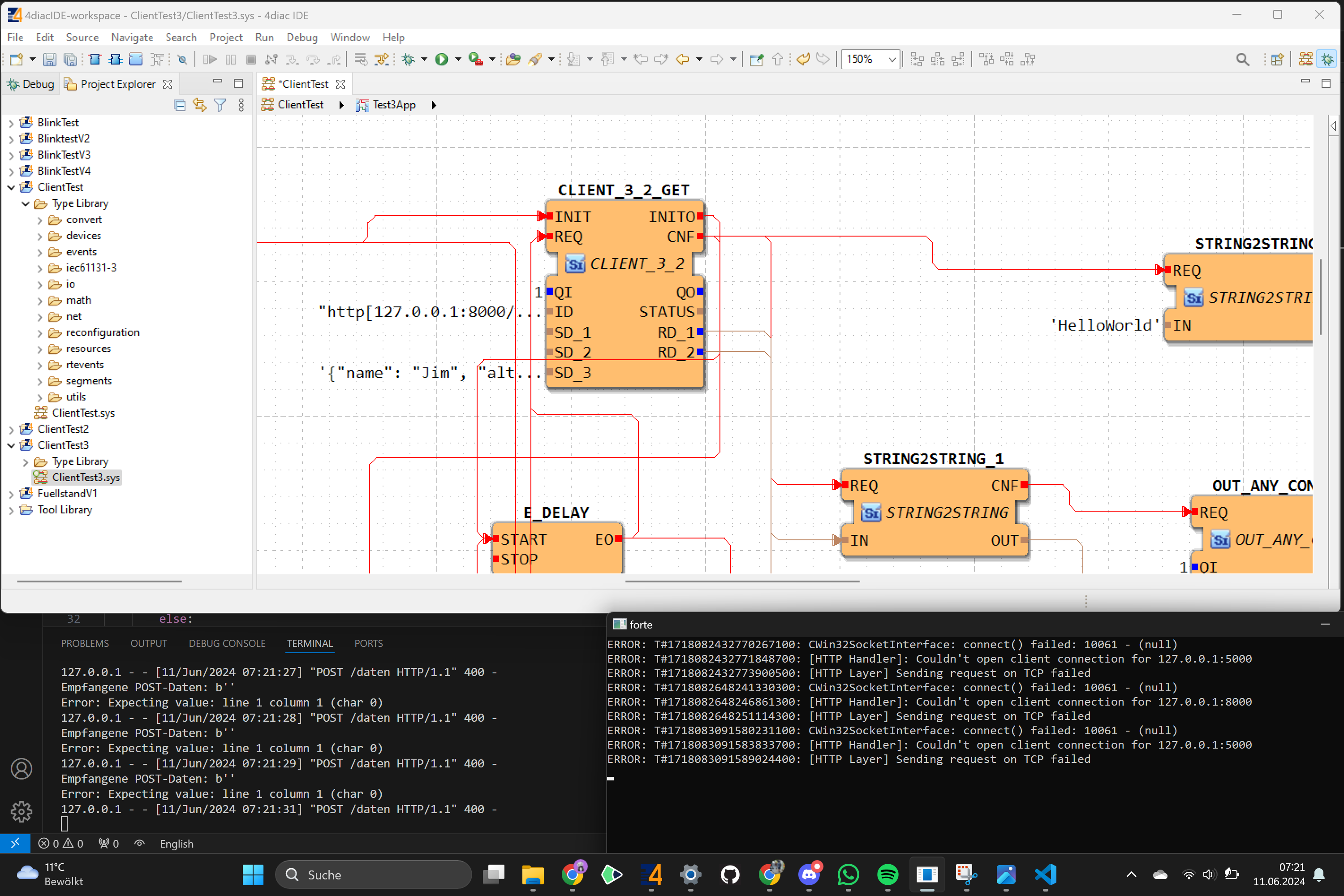

Re: Client with http-server [message #1866933 is a reply to message #1866852] Tue, 11 June 2024 01:25 Go to previous messageGo to next message

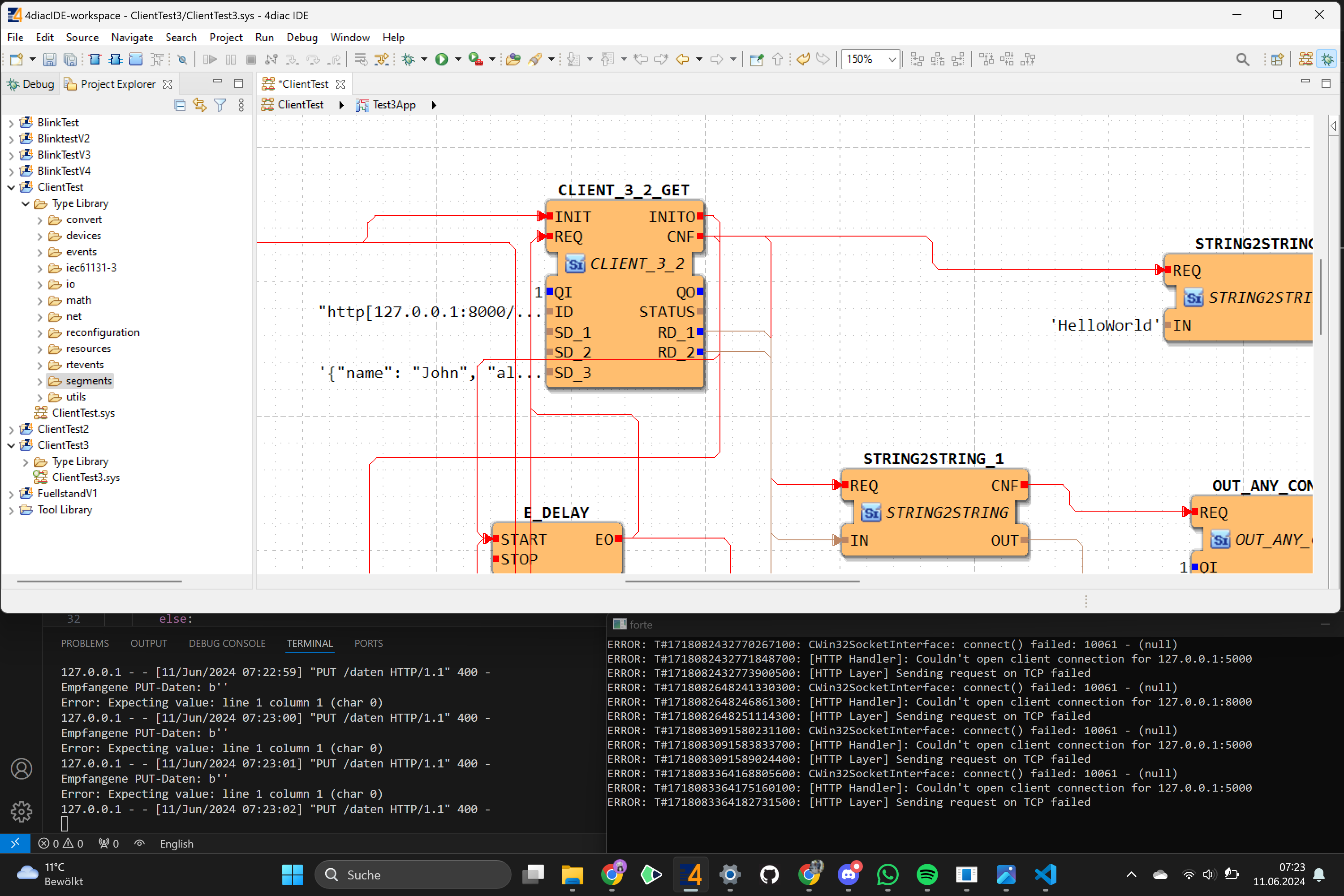

I used now the develop version of forte. I also created a client_3_2 (3SD and 2RD). I was able to create a GET-communication with my server.
But the POST and PUT-requests doesn't work at the moment.
I created a Server who accepts all types of requests GET/POST/PUT. It worked if I did a curl request.
POST-request: curl -X POST http://localhost:8000/daten -H "Content-Type: application/json" -d "{\"name\": \"John\", \"alter\": 30, \"verheiratet\": true, \"haustiere\": [\"Hund\", \"Katze\"]}"
PUT-request: curl -X PUT http://localhost:8000/daten -H "Content-Type: application/json" -d "{\"name\": \"John\", \"alter\": 30, \"verheiratet\": false, \"haustiere\": [\"Hamster\"]}"
My main issue is that the json-data not correctly arrives. Some data is arriving certified trough the line: Empfangene Daten erhalten -b' '
But not the right one.
I can't copy my curl -body (json-string) directly because I would need double qoutes around my wstring-body, but every double quotes around e.g. "name" causes an issue.
With single quotes and backslashes I'm getting the same result.
I added in the files my used python http-server, my post & put request and my client configuration.
Dustin
Re: Client with http-server [message #1866945 is a reply to message #1866933] Tue, 11 June 2024 05:37 Go to previous messageGo to next message
Not sure if this helps but the escape character for IEC 61131-3 Strings and WStrings is the $ instead of the \. So if you need to escape double quotes you need to use $" in 4diac IDE.

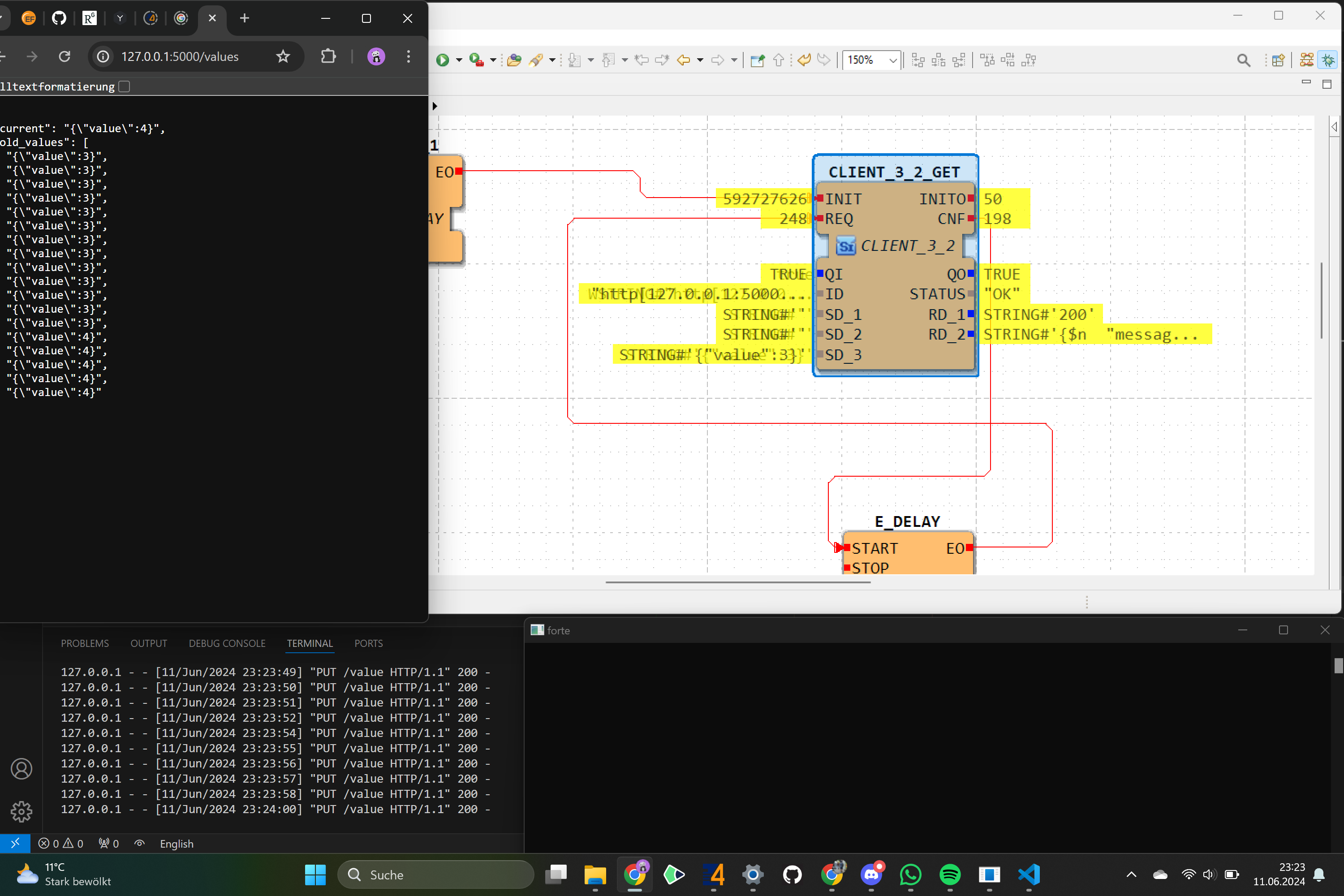

Re: Client with http-server [message #1866963 is a reply to message #1866945] Tue, 11 June 2024 05:53 Go to previous messageGo to next message
not sure if it helps, but the inputs of this fb are of type ANY and i think you should add a type e.g. STRING#'' for all empty inputs, and STRING#'my text' for your input with content as well as WSTRING#"my ID"
Re: Client with http-server [message #1866999 is a reply to message #1866963] Tue, 11 June 2024 17:29 Go to previous messageGo to next message
Thanks for all of you help!
Monikas last tip solved my problem from the former message.
I add two screenshots and my http-server here so I can get involved in the documentation or if someone else have the same problems.
