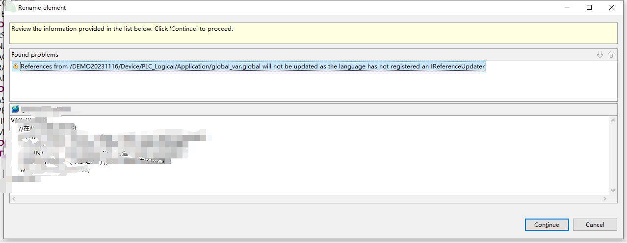

I renamed variable "abcd" in xxx.a from popup menu "Rename Element".
The xtext showed me a error dialog, saied:
Reference from xxxx will not be updated as the language has not registered an IReferenceUpdater.
How can I implement "Rename Element" function?

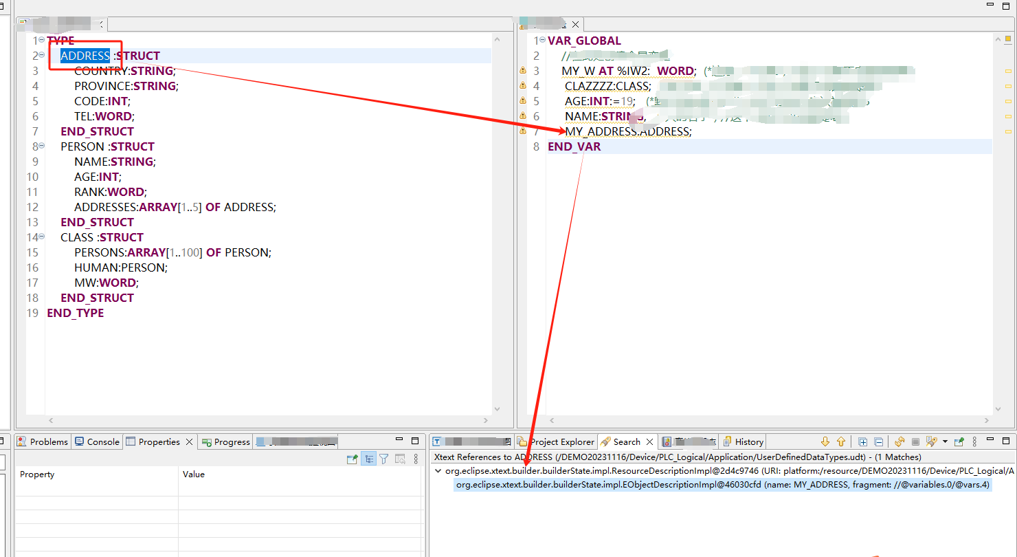

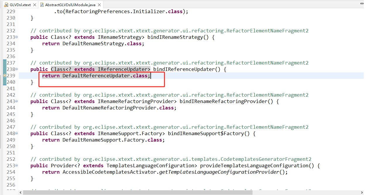

I made use of xtext cross references in my grammar.
index.php/fa/43862/0/
In AbstractGLVDslUiModule.java, the DefaultReferenceUpdater.java was injected.
index.php/fa/43860/0/
The popup menu "Find references" in xtext worked well.
index.php/fa/43861/0/
[Updated on: Fri, 29 December 2023 06:33] by Moderator

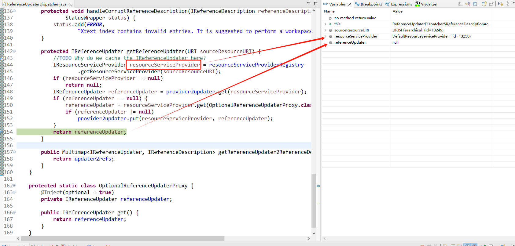

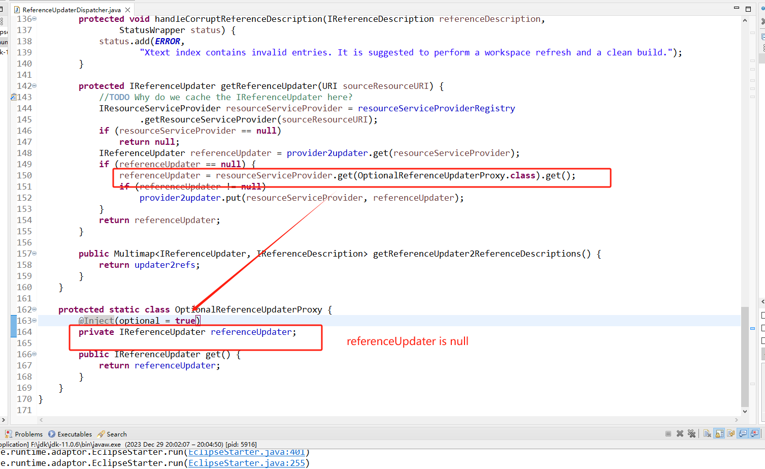

In instance of OptionalReferenceUpdaterProxy,The referenceUpdater field is null.
index.php/fa/43863/0/
  • Attachment: null.png
    (Size: 89.19KB, Downloaded 501 times)
Re: Reference from xxxx will not be updated as the language has not registered an IReferenceUpdater [message #1862790 is a reply to message #1862789] Fri, 29 December 2023 07:16 Go to previous messageGo to next message
Yes but this should not happen if you register dsls oropetly.

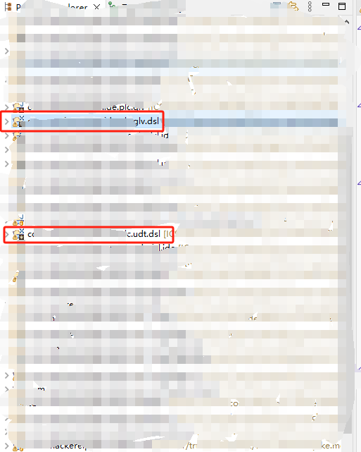

My two DSLs are in two projects.
index.php/fa/43864/0/
  • Attachment: dsls.png
    (Size: 69.46KB, Downloaded 515 times)

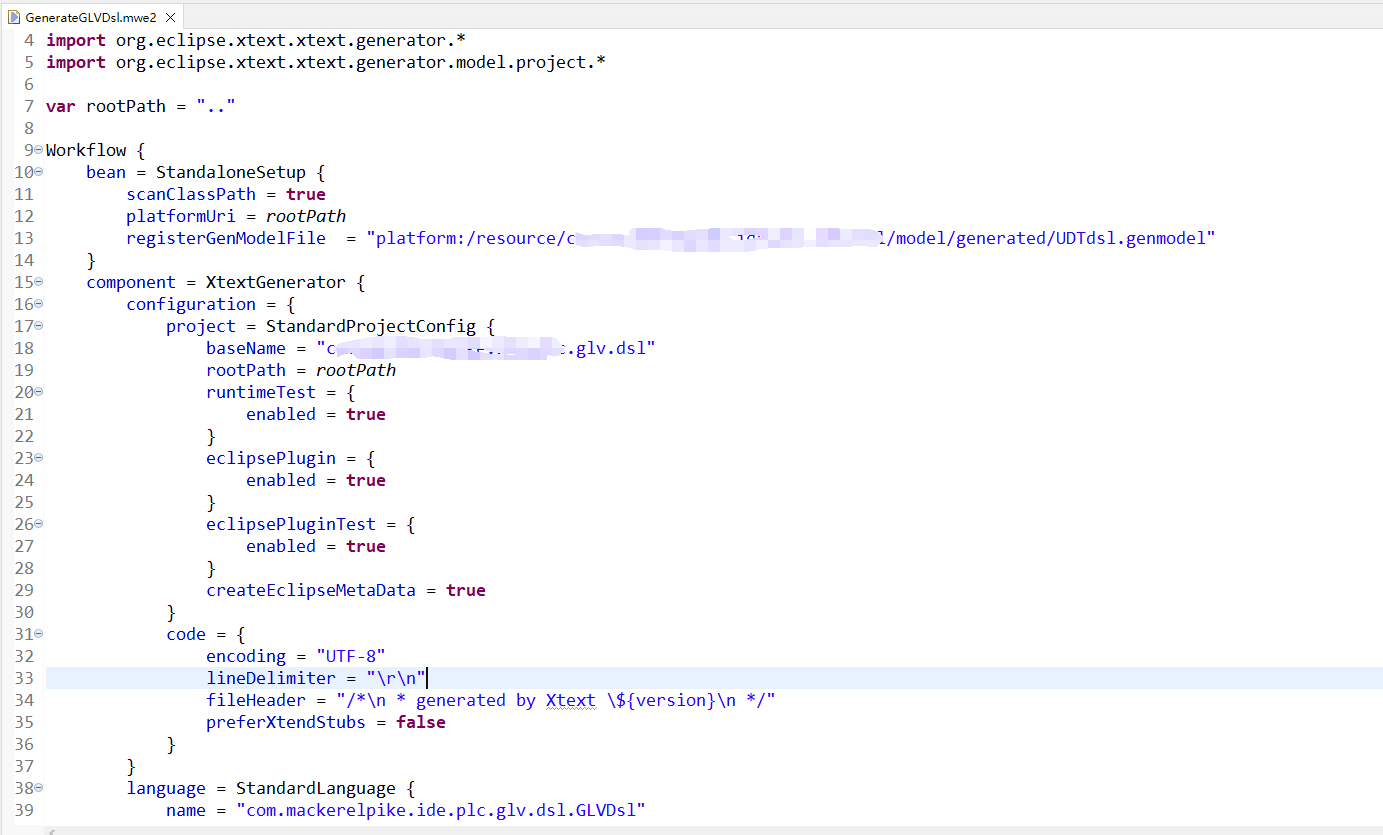

This is my GenerateGLVDsl.mwe2:
index.php/fa/43865/0/
  • Attachment: workflow.png
    (Size: 46.18KB, Downloaded 497 times)

This is my GenerateGLVDsl.mwe2 :

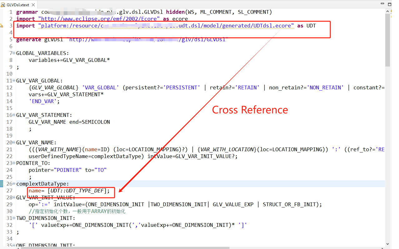

GLVDsl.xtext
grammar com.abcd.glv.dsl.GLVDsl hidden(WS, ML_COMMENT, SL_COMMENT)
import "http://www.eclipse.org/emf/2002/Ecore" as ecore
import "platform:/resource/com.abcd.udt.dsl/model/generated/UDTdsl.ecore" as UDT
generate gLVDsl "http://www.xxxxx.com/ide/plc/glv/dsl/GLVDsl"
GLOBAL_VARIABLES:
	variables+=GLV_VAR_GLOBAL*
GLV_VAR_GLOBAL:
	{GLV_VAR_GLOBAL} 'VAR_GLOBAL' (persistent?='PERSISTENT' | retain?='RETAIN' | non_retain?='NON_RETAIN' | constant?='CONSTANT')?
	vars+=GLV_VAR_STATEMENT*
	'END_VAR';
GLV_VAR_STATEMENT:
	GLV_VAR_NAME end=SEMICOLON
GLV_VAR_NAME:
	(({VAR_WITH_NAME}(name=ID) (loc=LOCATION_MAPPING)?) | {VAR_WITH_LOCATION}(loc=LOCATION_MAPPING)) ':' ((ref_to?='REF_TO') | (pointer_to?=POINTER_TO))? (array=GLV_ARRAY_TYPE)?  ((type=GLV_BASIC_TYPE) |
	userDefinedTypeName=complextDataType) intValue=GLV_VAR_INIT_VALUE?;
POINTER_TO:
	pointer="POINTER" to="TO"
complextDataType:
	name= [UDT::UDT_TYPE_DEF];
GLV_VAR_INIT_VALUE:
	op=':=' initValue=(ONE_DIMENSION_INIT |TWO_DIMENSION_INIT| GLV_VALUE_EXP | STRUCT_OR_FB_INIT);
TWO_DIMENSION_INIT:
	'[' valueExp+=ONE_DIMENSION_INIT(','valueExp+=ONE_DIMENSION_INIT)* ']'
ONE_DIMENSION_INIT:
	'[' valueExp+=(GLV_VALUE_EXP | STRUCT_OR_FB_INIT)(','valueExp+=(GLV_VALUE_EXP | STRUCT_OR_FB_INIT))* ']';
STRUCT_OR_FB_INIT:
	leftbrace="(" paramList=INIT_PARAM_LIST rightbrace=")"
INIT_PARAM_LIST:
	in+=INIT_PARAM (',' (comments+=ML_COMMENT)? in+=INIT_PARAM)*;
INIT_PARAM:
	(inName=ID ':=' (comments+=ML_COMMENT)?)? exp=(ONE_DIMENSION_INIT |TWO_DIMENSION_INIT| GLV_VALUE_EXP | STRUCT_OR_FB_INIT);
GLV_VALUE_EXP:
	(boolValue=('TRUE' | 'FALSE') | idValue=ID | strValue=STRING | intValueWithPlusOrMinus=INT_WITH_PLUS_MINUS |
	intValue=INT | timeValue=TIME | todValue=TOD | dateValue=DATE | durationValue=DURATION | dtValue=DT | hexValue=HEX |
	octValue=OCT | binaryValue=BINARY | real_value=REAL_NUMBER);
LOCATION_MAPPING:
	'AT' LOCATION;
GLV_ARRAY_TYPE hidden(WS):
	'ARRAY' '[' dimension=DIMENSION ']' 'OF';
DIMENSION:
	dimension+=subrange_type (',' dimension+=subrange_type)*;
subrange_type:
	lower=INT upto=UPTO upper=INT;
terminal SEMICOLON:
GLV_BASIC_TYPE:
	value=('BIT' | 'BOOL' | 'BYTE' | 'WORD' | 'DWORD' | 'LWORD' | 'SINT' | 'USINT' | 'INT' | 'UINT' | 'DINT' | 'UDINT'
	| 'LINT' | 'REAL' | 'LREAL' | 'STRING' | 'TIME' | 'TIME_OF_DAY' | 'TOD' | 'DATE' | 'DATE_AND_TIME' | 'DT' | 'WSTRING'
	| 'ANY' | 'ANY_INT'
	| 'ANY_REAL' | 'ANY_NUM' | 'ANY_DATE' | 'ANY_BIT');
terminal TIME:
	('T#' | 't#') (INT 'h')? (INT 'm')? (INT 's')?;
terminal DATE:
	('d#'|'D#') INT '-' INT '-' INT;
terminal DURATION:
	('T#' | 't#') (INT 'd')? (INT 'h')? (INT 'm')? (INT 's')? (INT (. 'INT')? 'ms')?;
terminal DT:
	('dt#'|'DT#') INT '-' INT '-' INT '-' INT ':' INT ':' INT ('.' INT)?;
terminal TOD:
	('tod#'|'TOD#') INT ':' INT ':' INT ('.' INT)?;
terminal HEX:
	'16#' ('0'..'9' | 'a'..'f' | 'A'..'F' | '_')+;
terminal BINARY:
	'2#' ('0'..'1' | '_')+;
INT_WITH_PLUS_MINUS returns ecore::EIntegerObject:
	'-' INT;
terminal INT returns ecore::EIntegerObject:
	'0'..'9' ('0'..'9' | '_')*;
REAL_NUMBER returns ecore::EBigDecimal hidden():
	('-' | '+')? INT '.' (EXT_INT | INT);
terminal EXT_INT:
	INT ('e' | 'E') ('-' | '+')? INT;
terminal OCT:
	'8#' ('0'..'8')+
UPTO hidden(WS):
terminal LOCATION:
	'%' ('I' | 'Q' | 'M') (('*') | ('X' | 'B' | 'W' | 'D' | 'L')? ('0'..'9')+ (('.') ('0'..'9')+)?);
terminal ID:
		'^'? ('\u4E00'..'\u9FA5'|'\uF900'..'\uFA2D'|'a'..'z' | 'A'..'Z' | '_') ('a'..'z' | 'A'..'Z' | '_' | '0'..'9'|'\u4E00'..'\u9FA5'|'\uF900'..'\uFA2D')*;
terminal STRING:
	'"' ('\\' . /* 'b'|'t'|'n'|'f'|'r'|'u'|'"'|"'"|'\\' */ | !('\\' | '"'))* '"' |
	"'" ('\\' . /* 'b'|'t'|'n'|'f'|'r'|'u'|'"'|"'"|'\\' */ | !('\\' | "'"))* "'";
terminal fragment MLC_OTH:
terminal fragment MLC_OTH_RP:
terminal fragment MLC_LP_TOK:
	'('+ ('*' MLC_BODY | MLC_OTH_RP);
terminal fragment MLC_X_TOK:
	'*'+ (MLC_OTH | MLC_LP_TOK);
terminal fragment MLC_BODY:
	(MLC_OTH_RP | MLC_LP_TOK | MLC_X_TOK)* '*'+ ')';
terminal ML_COMMENT:
	'(*' MLC_BODY;
terminal SL_COMMENT:
	'//' !('\n' | '\r')* ('\r'? '\n')?;
terminal WS:
	(' ' | '\t' | '\r' | '\n')+;
terminal ANY_OTHER:
Re: Reference from xxxx will not be updated as the language has not registered an IReferenceUpdater [message #1862799 is a reply to message #1862798] Fri, 29 December 2023 10:02 Go to previous messageGo to next message
can you please provide the plugin.xml for global.ui
we need to find out why there is no
IResourceServiceProvider or entry here
in ReferenceUpdaterDispatcher
what resourceServiceProvider do you get.
(it is registered via plugin.xml)
if you copy your stuff to a new workspace/projects
do you still see the problem?
[Updated on: Fri, 29 December 2023 10:08] by Moderator

Re: Reference from xxxx will not be updated as the language has not registered an IReferenceUpdater [message #1862801 is a reply to message #1862799] Fri, 29 December 2023 10:28 Go to previous messageGo to next message
index.php/fa/43866/0/
Re: Reference from xxxx will not be updated as the language has not registered an IReferenceUpdater [message #1862802 is a reply to message #1862801] Fri, 29 December 2023 10:32 Go to previous messageGo to next message
Yea but I would expect a different class from ui project.
 * generated by Xtext 2.26.0
package com.abcd.glv.dsl.ui;
import com.google.inject.Binder;
import com.google.inject.Provider;
import com.google.inject.name.Names;
import com.abcd.glv.dsl.ide.contentassist.antlr.GLVDslParser;
import com.abcd.glv.dsl.ide.contentassist.antlr.PartialGLVDslContentAssistParser;
import com.abcd.glv.dsl.ide.contentassist.antlr.internal.InternalGLVDslLexer;
import com.abcd.glv.dsl.ui.contentassist.GLVDslProposalProvider;
import com.abcd.glv.dsl.ui.labeling.GLVDslDescriptionLabelProvider;
import com.abcd.glv.dsl.ui.labeling.GLVDslLabelProvider;
import com.abcd.glv.dsl.ui.outline.GLVDslOutlineTreeProvider;
import com.abcd.glv.dsl.ui.quickfix.GLVDslQuickfixProvider;
import com.abcd.glv.dsl.validation.GLVDslValidatorConfigurationBlock;
import org.eclipse.compare.IViewerCreator;
import org.eclipse.core.resources.IWorkspaceRoot;
import org.eclipse.core.resources.ResourcesPlugin;
import org.eclipse.jface.viewers.ILabelProvider;
import org.eclipse.ui.plugin.AbstractUIPlugin;
import org.eclipse.xtext.builder.BuilderParticipant;
import org.eclipse.xtext.builder.EclipseOutputConfigurationProvider;
import org.eclipse.xtext.builder.IXtextBuilderParticipant;
import org.eclipse.xtext.builder.builderState.IBuilderState;
import org.eclipse.xtext.builder.clustering.CurrentDescriptions;
import org.eclipse.xtext.builder.impl.PersistentDataAwareDirtyResource;
import org.eclipse.xtext.builder.nature.NatureAddingEditorCallback;
import org.eclipse.xtext.builder.preferences.BuilderPreferenceAccess;
import org.eclipse.xtext.generator.IContextualOutputConfigurationProvider;
import org.eclipse.xtext.ide.LexerIdeBindings;
import org.eclipse.xtext.ide.editor.contentassist.antlr.IContentAssistParser;
import org.eclipse.xtext.ide.editor.contentassist.antlr.internal.Lexer;
import org.eclipse.xtext.ide.editor.partialEditing.IPartialEditingContentAssistParser;
import org.eclipse.xtext.parser.antlr.AntlrTokenDefProvider;
import org.eclipse.xtext.parser.antlr.ITokenDefProvider;
import org.eclipse.xtext.parser.antlr.LexerProvider;
import org.eclipse.xtext.resource.IResourceDescriptions;
import org.eclipse.xtext.resource.containers.IAllContainersState;
import org.eclipse.xtext.resource.impl.ResourceDescriptionsProvider;
import org.eclipse.xtext.service.SingletonBinding;
import org.eclipse.xtext.ui.DefaultUiModule;
import org.eclipse.xtext.ui.UIBindings;
import org.eclipse.xtext.ui.codetemplates.ui.AccessibleCodetemplatesActivator;
import org.eclipse.xtext.ui.codetemplates.ui.partialEditing.IPartialEditingContentAssistContextFactory;
import org.eclipse.xtext.ui.codetemplates.ui.partialEditing.PartialEditingContentAssistContextFactory;
import org.eclipse.xtext.ui.codetemplates.ui.preferences.AdvancedTemplatesPreferencePage;
import org.eclipse.xtext.ui.codetemplates.ui.preferences.TemplatesLanguageConfiguration;
import org.eclipse.xtext.ui.codetemplates.ui.registry.LanguageRegistrar;
import org.eclipse.xtext.ui.codetemplates.ui.registry.LanguageRegistry;
import org.eclipse.xtext.ui.compare.DefaultViewerCreator;
import org.eclipse.xtext.ui.editor.DocumentBasedDirtyResource;
import org.eclipse.xtext.ui.editor.IXtextEditorCallback;
import org.eclipse.xtext.ui.editor.contentassist.ContentAssistContext;
import org.eclipse.xtext.ui.editor.contentassist.FQNPrefixMatcher;
import org.eclipse.xtext.ui.editor.contentassist.IContentProposalProvider;
import org.eclipse.xtext.ui.editor.contentassist.IProposalConflictHelper;
import org.eclipse.xtext.ui.editor.contentassist.PrefixMatcher;
import org.eclipse.xtext.ui.editor.contentassist.antlr.AntlrProposalConflictHelper;
import org.eclipse.xtext.ui.editor.contentassist.antlr.DelegatingContentAssistContextFactory;
import org.eclipse.xtext.ui.editor.outline.IOutlineTreeProvider;
import org.eclipse.xtext.ui.editor.outline.impl.IOutlineTreeStructureProvider;
import org.eclipse.xtext.ui.editor.preferences.IPreferenceStoreInitializer;
import org.eclipse.xtext.ui.editor.quickfix.IssueResolutionProvider;
import org.eclipse.xtext.ui.editor.templates.XtextTemplatePreferencePage;
import org.eclipse.xtext.ui.refactoring.IDependentElementsCalculator;
import org.eclipse.xtext.ui.refactoring.IReferenceUpdater;
import org.eclipse.xtext.ui.refactoring.IRenameRefactoringProvider;
import org.eclipse.xtext.ui.refactoring.IRenameStrategy;
import org.eclipse.xtext.ui.refactoring.impl.DefaultDependentElementsCalculator;
import org.eclipse.xtext.ui.refactoring.impl.DefaultReferenceUpdater;
import org.eclipse.xtext.ui.refactoring.impl.DefaultRenameRefactoringProvider;
import org.eclipse.xtext.ui.refactoring.impl.DefaultRenameStrategy;
import org.eclipse.xtext.ui.refactoring.ui.DefaultRenameSupport;
import org.eclipse.xtext.ui.refactoring.ui.IRenameSupport;
import org.eclipse.xtext.ui.refactoring.ui.RefactoringPreferences;
import org.eclipse.xtext.ui.resource.ResourceServiceDescriptionLabelProvider;
import org.eclipse.xtext.ui.shared.Access;
import org.eclipse.xtext.ui.validation.AbstractValidatorConfigurationBlock;
 * Manual modifications go to {@link GLVDslUiModule}.
@SuppressWarnings("all")
public abstract class AbstractGLVDslUiModule extends DefaultUiModule {
	public AbstractGLVDslUiModule(AbstractUIPlugin plugin) {
		super(plugin);
	// contributed by org.eclipse.xtext.xtext.generator.ImplicitFragment
	public Provider<? extends IAllContainersState> provideIAllContainersState() {
		return Access.getJavaProjectsState();
	// contributed by org.eclipse.xtext.xtext.generator.parser.antlr.XtextAntlrGeneratorFragment2
	public Class<? extends IProposalConflictHelper> bindIProposalConflictHelper() {
		return AntlrProposalConflictHelper.class;
	public void configureContentAssistLexer(Binder binder) {
		binder.bind(Lexer.class)
			.annotatedWith(Names.named(LexerIdeBindings.CONTENT_ASSIST))
			.to(InternalGLVDslLexer.class);
	public void configureHighlightingLexer(Binder binder) {
		binder.bind(org.eclipse.xtext.parser.antlr.Lexer.class)
			.annotatedWith(Names.named(LexerIdeBindings.HIGHLIGHTING))
			.to(com.abcd.glv.dsl.parser.antlr.internal.InternalGLVDslLexer.class);
	public void configureHighlightingTokenDefProvider(Binder binder) {
		binder.bind(ITokenDefProvider.class)
			.to(AntlrTokenDefProvider.class);

	public Class<? extends IRenameStrategy> bindIRenameStrategy() {
		return DefaultRenameStrategy.class;
	// contributed by org.eclipse.xtext.xtext.generator.ui.refactoring.RefactorElementNameFragment2
	public Class<? extends IReferenceUpdater> bindIReferenceUpdater() {
		return DefaultReferenceUpdater.class;
	public Class<? extends IRenameRefactoringProvider> bindIRenameRefactoringProvider() {
		return DefaultRenameRefactoringProvider.class;
	public Class<? extends IRenameSupport.Factory> bindIRenameSupport$Factory() {
		return DefaultRenameSupport.Factory.class;

Re: Reference from xxxx will not be updated as the language has not registered an IReferenceUpdater [message #1862804 is a reply to message #1862802] Fri, 29 December 2023 10:33 Go to previous messageGo to next message
<extension point="org.eclipse.xtext.extension_resourceServiceProvider">
<resourceServiceProvider
class="com.abcd.glv.dsl.ui.GLVDslExecutableExtensionFactory:org.eclipse.xtext.ui.resource.IResourceUIServiceProvider"
uriExtension="glv">
</resourceServiceProvider>
</extension>
No global here
Did you really compare with plugin..xml_gen
Re: Reference from xxxx will not be updated as the language has not registered an IReferenceUpdater [message #1862805 is a reply to message #1862804] Fri, 29 December 2023 10:48 Go to previous messageGo to next message

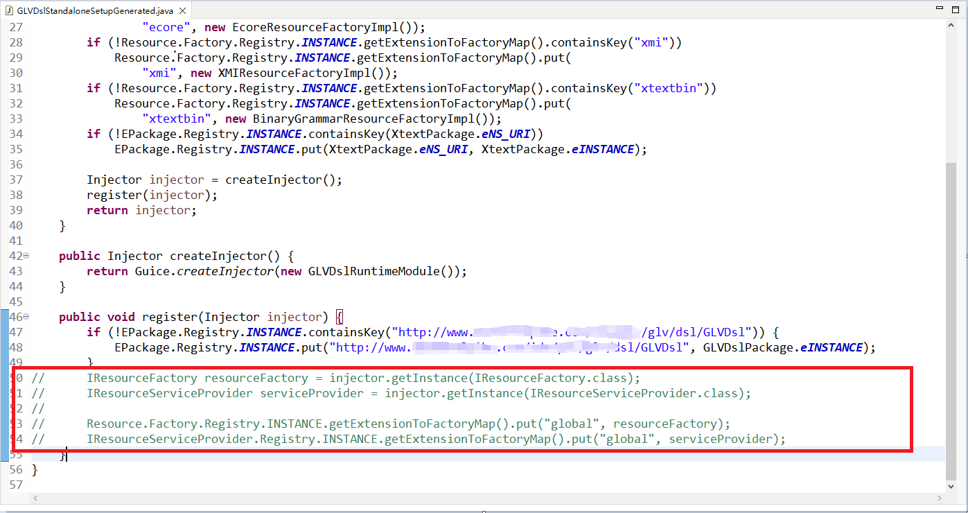

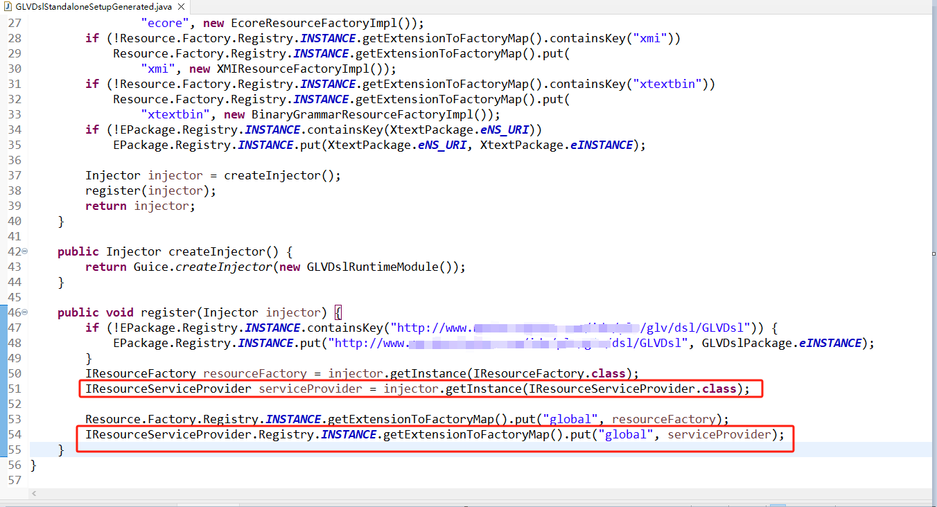

I synchronized plugin.xml_gen and plugin.xml。

But the referenceUpdater filed in OptionalReferenceUpdaterProxy is still null.

I found the reason that the field referenceUpdater in object of OptionalReferenceUpdaterProxy was null.
index.php/fa/43871/0/

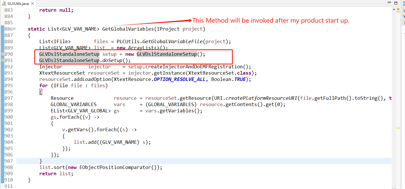

In My GLVUtils.class, I created object of GLVDslStandaloneSetup.
index.php/fa/43870/0/
In the register method of GLVDslStandaloneSetup, the following code will regester DefaultResourceServiceProvider.
index.php/fa/43874/0/
I commented out those codes,then the "rename element" worked well.
index.php/fa/43873/0/

Never ever call stand-alone setup from code that runs in eclipse
Re: Reference from xxxx will not be updated as the language has not registered an IReferenceUpdater [message #1862816 is a reply to message #1862815] Sat, 30 December 2023 02:16 Go to previous messageGo to next message
I need to parse DSL source code file, what do i do ?
Re: Reference from xxxx will not be updated as the language has not registered an IReferenceUpdater [message #1862817 is a reply to message #1862816] Sat, 30 December 2023 02:27 Go to previous messageGo to next message
Sorry, I asked chatgpt.It told me how to do .
Thanks a lot !
Re: Reference from xxxx will not be updated as the language has not registered an IReferenceUpdater [message #1862819 is a reply to message #1862817] Sat, 30 December 2023 02:41 Go to previous message
for completeness: http://koehnlein.blogspot.com/2012/11/xtext-tip-how-do-i-get-guice-injector.html
