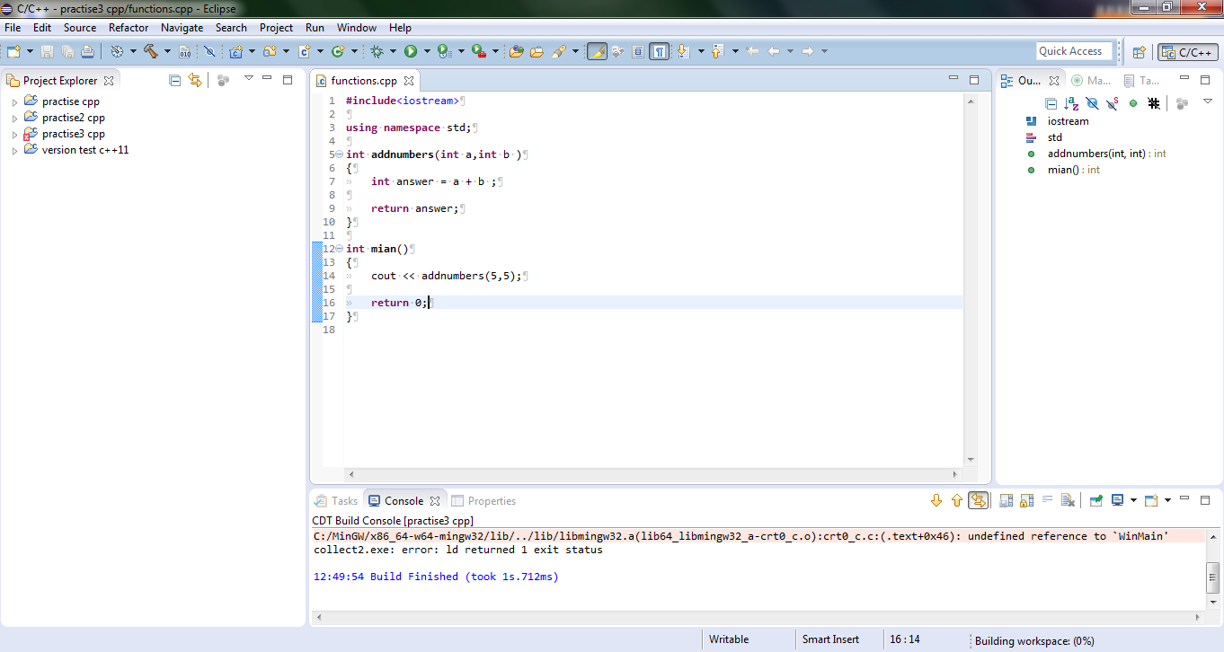

Re: Launch failed. Binary not found. [message #1694913 is a reply to message #1694255] Sat, 09 May 2015 00:55 Go to previous messageGo to next message
I have the same problem,i've attached an example of the problem. i have tried all above suggestions but problems remains and its still not creating binaries mostly when we works with multiple functions
error says,
C:/MinGW/x86_64-w64-mingw32/lib/../lib/libmingw32.a(lib64_libmingw32_a-crt0_c.o):crt0_c.c:(.text+0x46): undefined reference to `WinMain'
collect2.exe: error: ld returned 1 exit
waiting for helpful response. Thank you.
Re: Launch failed. Binary not found. [message #1695089 is a reply to message #1694913] Mon, 11 May 2015 20:20 Go to previous messageGo to next message
> error says,
Assuming that functions.cpp is supposed to contain the entry point for
your program, you need to change the spelling of the mian function to be
main.
Re: Launch failed. Binary not found. [message #1695339 is a reply to message #1695089] Wed, 13 May 2015 10:26 Go to previous messageGo to next message
Thanks, actually my sight never went to that line.
but it supposed to give error with description about that spelling mistake.
Re: Launch failed. Binary not found. [message #1695393 is a reply to message #1695339] Wed, 13 May 2015 20:44 Go to previous messageGo to next message
What you initially typed is a valid function name so the only error that
you can expect in this case is the error that you received when the
linker tried to link your executable.

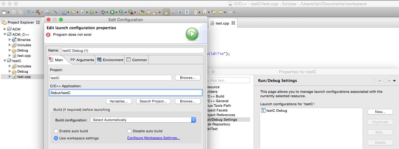

icon10.gif  Re: Launch failed. Binary not found. [message #1702790 is a reply to message #1437980] Fri, 24 July 2015 10:51 Go to previous messageGo to next message
Project > Properties > Run/Debug Settings
Click 'New...' button
Choose 'C/C++ Application' and then Edit Configuration window will be opened.
Enter Debug/"your project name"in C/C++ Application box(?) on the Main tab.
I figured out this problem by using this solution.
hope it will help you.

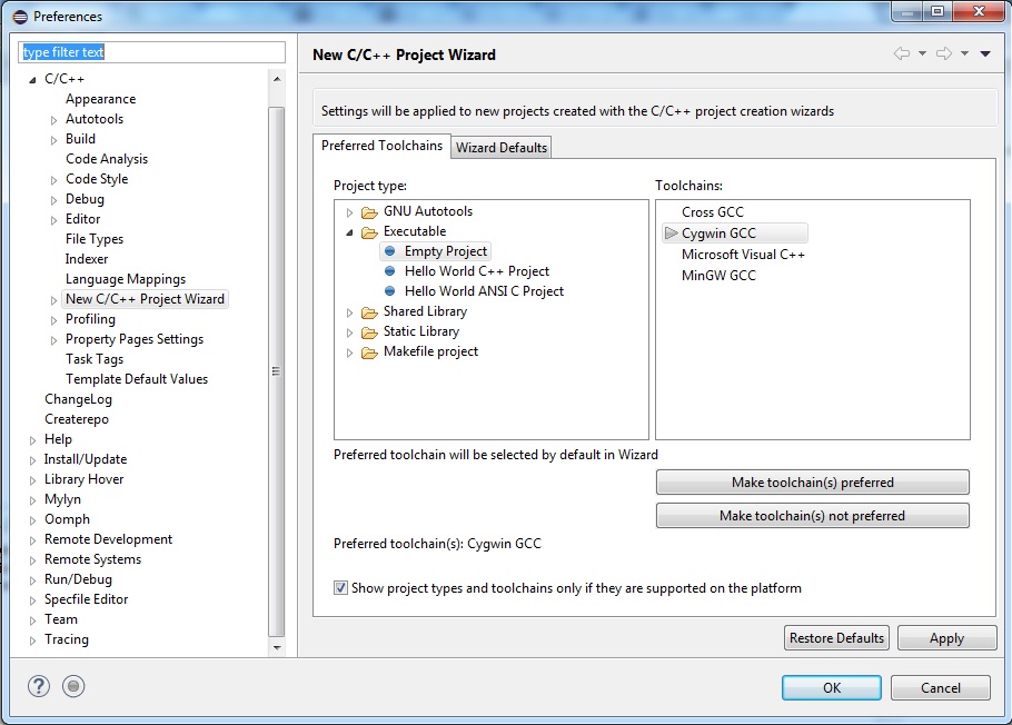

Re: Launch failed. Binary not found. [message #1706758 is a reply to message #1437980] Sun, 30 August 2015 05:35 Go to previous messageGo to next message
I changed the preferred tool chain to Cygwin gcc and now it works very well. have a look at the image.

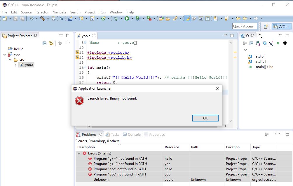

Re: Launch failed. Binary not found. [message #1727745 is a reply to message #1437980] Sat, 26 March 2016 11:57 Go to previous messageGo to next message
I too have the same problem n have no solution for this ... someone help!!
index.php/fa/25426/0/
  • Attachment: erreur.JPG
    (Size: 89.90KB, Downloaded 348776 times)

Re: Launch failed. Binary not found. [message #1727762 is a reply to message #1727746] Sat, 26 March 2016 20:37 Go to previous messageGo to next message
which executable file should i select ?
None. You don't have one. Eclipse can't find GCC to make it.
This may help: http://www.eclipse.org/forums/index.php/t/697857/

In the new 2020 C++ for developers to set your Binary Parser go to:
Window >> Preferences >> C/C++ >> New C/C++ Project Wizard >> Makefile Project >> Binary Parsers >>
select the parser for your system - PE64 Windows Parser (for Windows is most common)

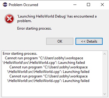

Re: Launch failed. Binary not found. [message #1861600 is a reply to message #1720041] Sat, 21 October 2023 01:09 Go to previous messageGo to next message
hi,
I followed the previous steps you mentioned, but I didn't find any file ending with '.d'. so I still have an error:
Launching " HelloWorld Debug" has encountered a problem
Error starting process.
I use Eclipse IDE 9/2023
thanks in advance and regards
Sobhy
  • Attachment: eclipse.jpg
    (Size: 45.61KB, Downloaded 327 times)
Re: Launch failed. Binary not found. [message #1861612 is a reply to message #1861600] Sun, 22 October 2023 13:16 Go to previous messageGo to next message
It seems that you're attempting to run the source file (*.cpp). The project must be built and the resulting binary run file can be run.
Re: Launch failed. Binary not found. [message #1863054 is a reply to message #1861612] Fri, 12 January 2024 13:08 Go to previous message
