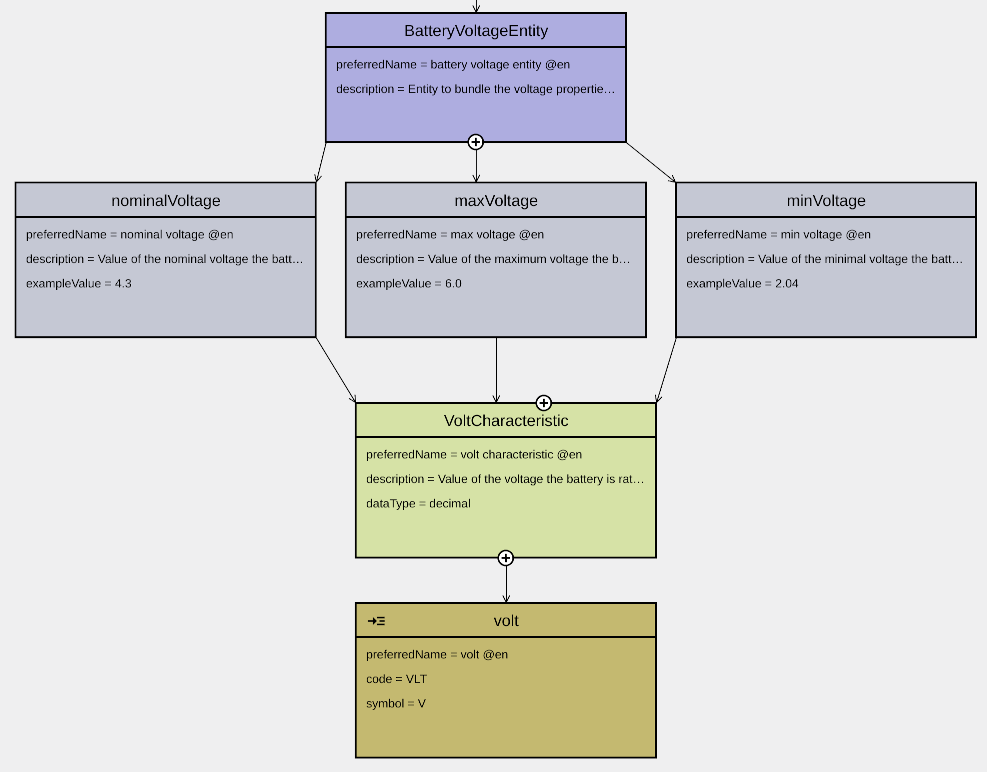

To give a feeling what this exactly means, let us consider a simple example which is based on a subset of a real-world use case. The "Battery Pass" use case in Catena-X contains an eponymous SAMM Aspect Model which models, among other things, a battery and three of its properties: minVoltage, maxVoltage and nominalVoltage. There are two parts to the domain semantics here: There are the properties themselves and what they mean in the context, and there is the fact that the properties talk about the concept of voltage, which implies a numeric datatype. Furthermore, the unit their values are given in needs to be made explicit - is it volt, millivolt or something different altogether? In the Aspect Model, the concept of voltage - the thing the properties talk about - is explicitly named. It can have human readable name and descriptions in multiple languages and most importantly, it has an identifier and can be referenced. This allows modelers in the scope of the same domain - or even across domains, in case of generally applicable Characteristics - to reuse this concept, to refer to this exact concept. Aspect Models require every property to explicitly refer to a Characteristic, so modelers are not only encouraged, but forced, to make a property's semantics explicit. The following image shows the corresponding part of the BatteryPass Aspect Model as shown in the Aspect Model Editor.
index.php/fa/43522/0/
The Characteristic is the embodiment of the domain semantics that goes beyond the datatype and the property or properties that use it. Being a measurement, the VoltCharacteristic also contains the reference to the physical unit. Note that all additional information on the unit, such as its symbol and common code, are not modeled in the Aspect Model, but are provided by SAMM's unit catalog. The Aspect Model Editor conventiently displays such information inline. For another example on Characteristics, think about a model of a device that has two properties called serialNumber and consistsOfParts (pointing to a list of other serialNumbers). You'd model the SerialNumber Characteristic once - because that is the concept both properties talk about - and use it in the defintions of both properties. It's not the same thing as a data type - the data type is just string.

Now, how could the example look like using "pure" AAS? You'd first create a submodel or submodel template that contains the three property submodel elements minVoltage, maxVoltage and nominalVoltage. We'd want to use ConceptDescriptions to have the properties point to a given suitable description of the concept voltage. Let's assume there is a suitable referenceable element representing this concept, for example via an IRI in a well-known ontology or RDF vocabulary or via an IRDI in ECLASS, so we refer to its identifier as ConceptDescription.
This leads to two problems: Firstly, it could be difficult for other AAS authors to find the concept for reusing it in other AAS models, since it's identified by its external ID, not by a semantic ID. Unless you already exactly know the concept and its ID, you wouldn't know it, even if you indexed and searched through IDs of elements of published admin shells. Secondly, how are tool authors going to make use of the concept description in a portable way? They need to know and support (i.e., load, parse, evaluate) the formalism the referenced concept description is defined in. This is were SAMM can step in: If it's a first class citizen in the AAS tool landscape, evaluation of concept descriptions needs not longer be a random encounter.
