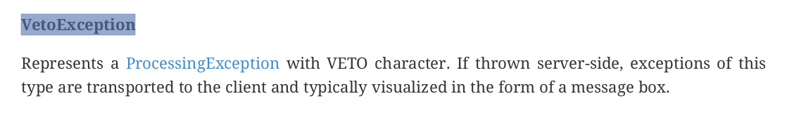

However, when I try this all I see is the login button turning red with a message saying login has failed and my VetoException message is NEVER displayed.
My understanding of a VetoException is that it is thrown server-side and is visible client side.
https://eclipsescout.github.io/scout-docs/23.1/technical-guide/common-concepts/exception-handling.html#vetoexception
How do I make the VetoException visible? If this is not possible, how do I display the exception message to the user?

Your understanding of a VetoException is correct regarding client server interaction via service tunnel. The text of a veto exception thrown on the server (backend) is displayed to the user in the client (ui).
The login box doesn't involve the service tunnel and thus behaves differently, the login box only knows one error message, see LoginBox._onPostFailImpl (ui.LoginFailed). It's not recommended to display detailed information to a user why a login failed. A credential verifier is only required to check if the username/password combination is valid, there is no need to apply other verifications such as password length checks.
If you're using the login box to register new users (as your code might suggest), I'd recommend to create an own box for that, with using own REST services to create such a user. The usage of a credential verifier for this use case is not recommended/doesn't work.
